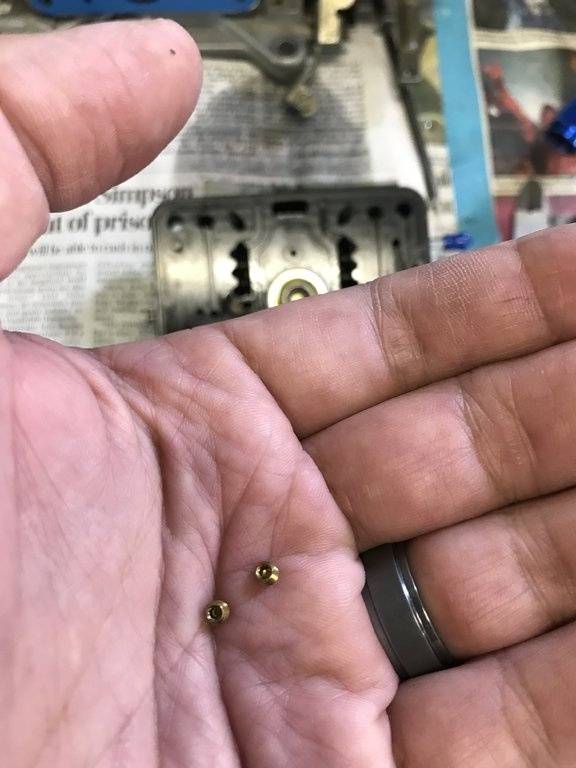

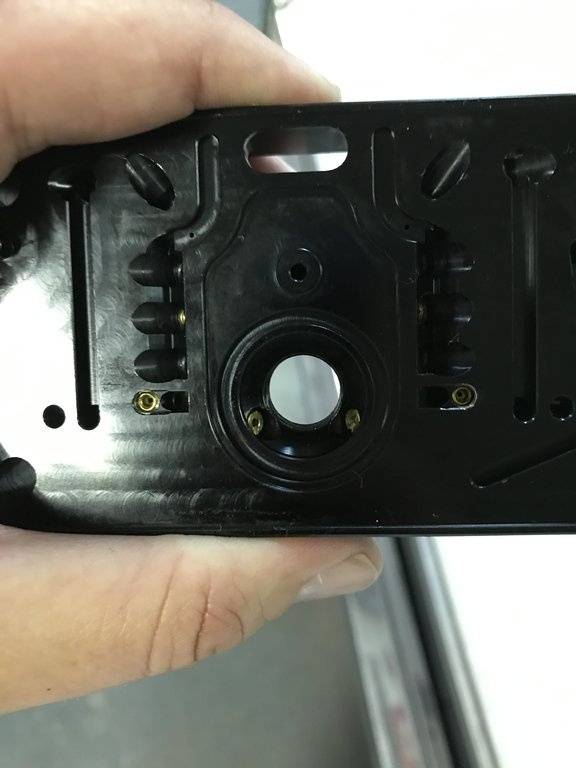

Your gonna have to find what the motor likes. The six pack carbs don't have adjustable air bleeds (unless you drill and tap them) so you are somewhat limited on your levers for adjustment. Generally a larger cammed engine will need to be in the 13's at idle. Example the roadrunner idles around 13.5 in neutral, in gear the vacuum drops and it goes 14.0. It then becomes a balancing act between idle and cruise. Get the idle fattened up to work good at low vacuum but under cruise you have high vacuum and the motor pulls like crazy an the idle circuit and is fat. Generally if you can get the motor into the low/mid 13's under cruise it'll be happy. Your plugs will stay clean and your mileage will be decent. Without adjustable bleeds you'll have to tweak your IFR's on the center carb and idle screws on all 3 carbs to find the happy medium. Under WOT its best to target fat then go to the strip and make adjustments from there. My 511 is fastest around 12.0. Also having the timing curve right will play a big part on your idle and cruise. I run premium pump gas. I'd have to check the ethanol content though.
I though I seen you had an adjustable metering block in the center. That's good, I had to go down to .032 on my IFR's to get that balance between idle and cruise. My motor only wants to pull 5.5 inches of vacuum at idle though so that adds to the complications.

Thanks for the input 68. My combo has about 10lbs of vacation at idle. Yes to IFRs. It was tuned on dyno and idled & pulled at WOT perfectly. But that was at 5000 ft. I guess I'll just have to wait till it's on the road.
