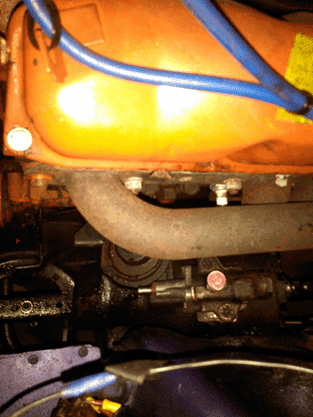

Well, since I'm working on my steering box I decided to replace my dipstick/tube. I didn't know what to buy for sure, so I bought the #2078 below. This is a 440 with headers in a '70 Road Runner.
Here's what my engine bay looks like with the headers and the old/bent/leaking aftermarket dipstick removed. This is driver's side cylinder #1 primary tube in the picture. I plan to secure this one to the motor mount bolt if possible. Will the #2078 fit or should I get a different one?
