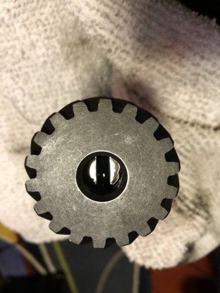

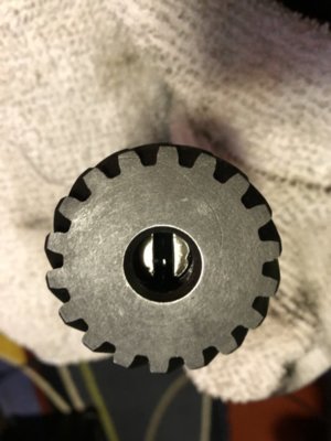

This is what my distributor gear looks like how do I line this up? 683BBBE7-D714-4175-9484-8F94CF898F28.jpeg
If you can’t get the gear to line up right, just drop it in as close as possible and with a flathead screwdriver turn it counter clockwise until it jumps the tooth and let it fall back in place.

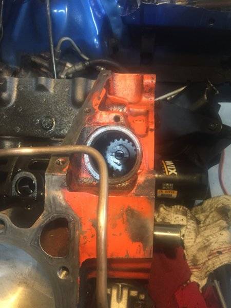

Too Much information can be harmful LOL i’m at top dead center On the compression stroke as seen in the first photo and the second photo Is pointing toward factory spark plug number one and not pointing toward the cam!
Should I just drop in the distributor and continue or ???
411A82FB-60B8-4C69-90D3-C5EA1C3CF725.jpeg C6A1FA56-B1F1-4F73-B61D-1A2020A6A1FA.jpeg
If you’re sitting at TDC on compression stroke I would move one tooth. If you’re at 10 o’clock now, I would try to be at 11 o’clock. The slot in the shaft should point at the #1 cylinder.
Use the screwdriver tip mentioned before. Move it tooth by tooth until you get it there.

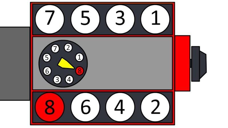

Confused-With MSD distributor #1 is at the 3 o'clock position facing the engine from the radiator. How to get to the normal factory position TDC #1?
Everything I was referencing was a factory setup. I have no idea about MSD or Mallory parts. The reason you do what I had noted is to make sure the vacuum can falls at a location to give you room to adjust timing. Here’s a diagram of what it should look like.
