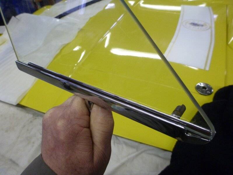

I am now detailing all my 69 Charger door hardware. I bought new AMD glass and need to install the stainless rear trim that attaches to the glass. I bought the material to attach the trim to the glass. What is the best procedure to attach this before I bumble it up. Thanks.

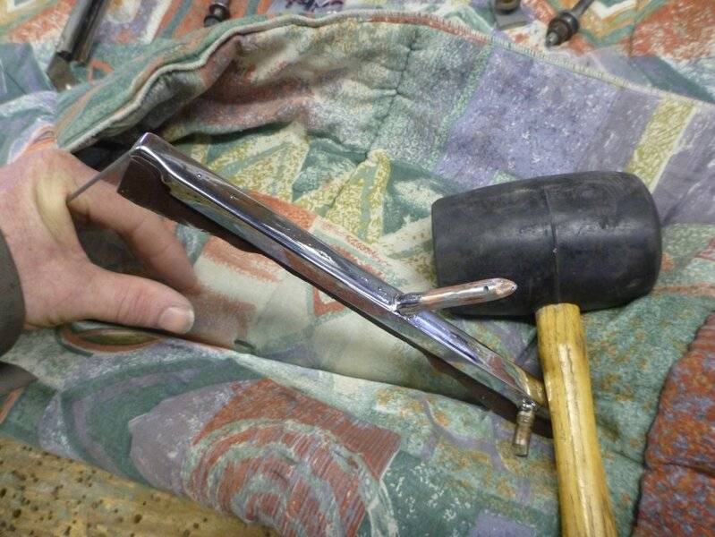

Setting tape? Lay it across the trim piece slot, use a rubber mallet to either tap the glass into the slot or the trim onto the glass. Trim tape extra with a sharp exacto knife.
Can't find pics of me fixing the Bird's door glass, but same deal here... just a different part..
