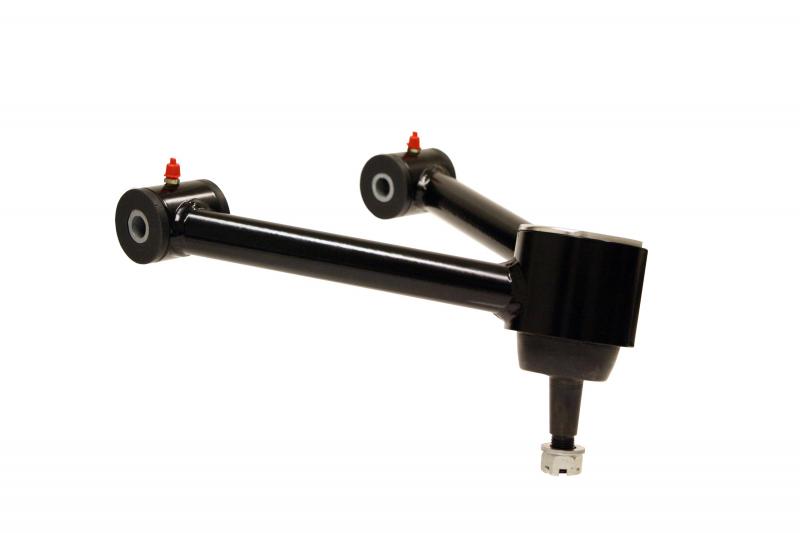

If your on a budget check out QA1, tubular k-member & tubular adj. upper control arms adj. or not,
even a tubular lower control arm, that has the sway bar mts. even, strut rods or dynamic adj. strut rods...

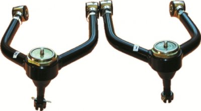

I like the SPC upper control arms {I got from Mancini Racing}
they are double adjustable, even while still on the car, easy peasy...
maybe not as cheap thou $250 ea. IIRC
