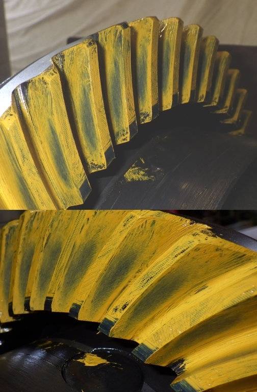

I have used a gear set from him, and will again. If I remember correctly, he sells a few different brands. Go with his recommendation. He is a great guy with some awesome tech support. Even had me send him pics to give advice on the gear lash pattern.

Fran I think you already knew what you wanted to do before u asked, BUT wow, asking for pics of gear pattern? The Dr. has to be ok in my book.

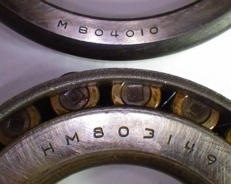

Just found that Strange before I came back to FBBO site and saw your post. Are you saying 742 gears will go in a 489 if you use the 489 rear pinion bearing and use pinion shims to set bearing preload? I'm not well versed in 8.75's to know that. Thanks, I'm interested in your answer.

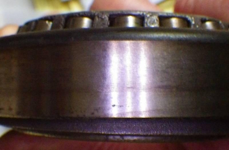

Evidently it can happen. If you go through my post in Abodies you'll see pictures of exactly what came out this 489. They used a crush sleeve behind the outer on the pinion that came out. No reason I can think of hard shims wouldn't work. I listed the inner bearing and race in a post. Outer bearing and races are same for both cases.
Here's what worked for the inner on the 742 pinion in the 489 case. The bearing does hang out of the small end of the race as assembled......
