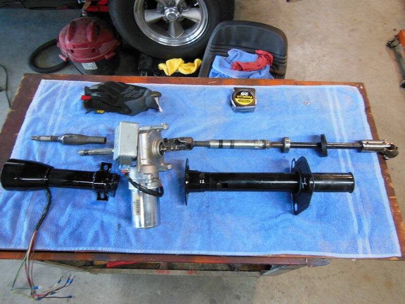

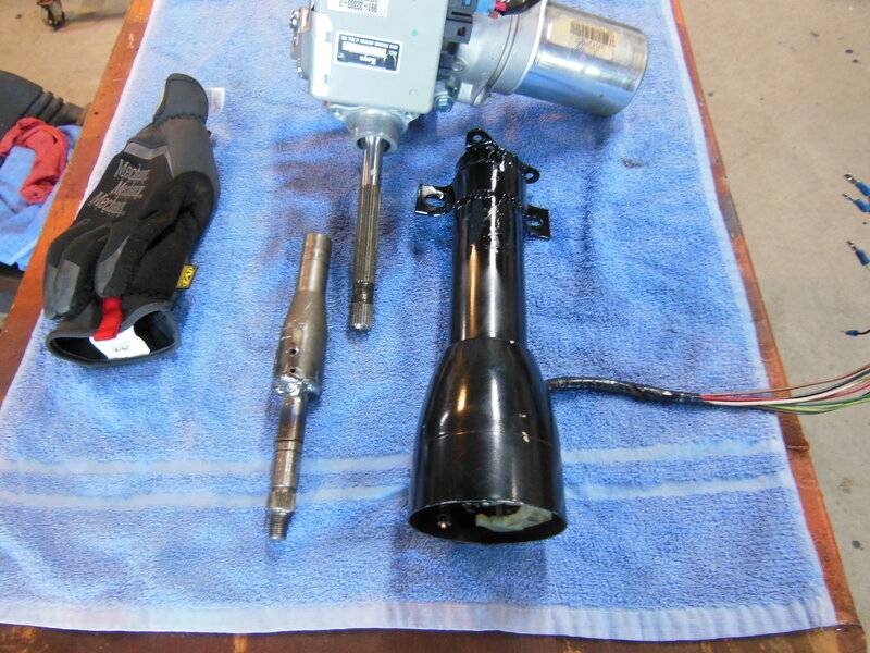

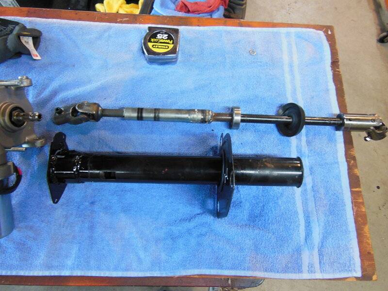

made some progress on my electric assist power steering,,spliced in a 2007 saturn vue EPAS unit. went with the vue because the car weighs 4000 lbs, unlike the prius unit that guys use that is for a 3000 lb car..half way done. need a couple of small parts from summit to final fit..weldable spline coupler and exhaust reducer to center the original steering tube....unit will work like originally intended by applying assist based upon vehicle speed using GPS. at speed very little, at slow speeds parking lots. driveways, etc, more..

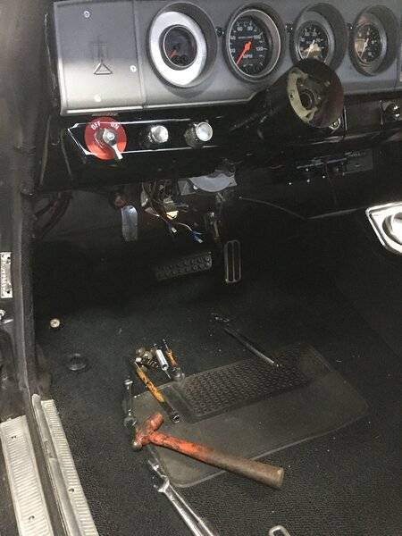

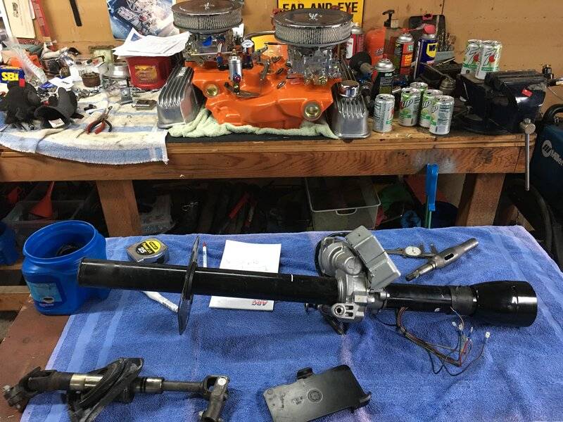

mocked up in car today,,lots of room. not very visable, if i was to put some black paint on the bottom of it, u would not realize it was there...i think this is going to be 1 of those ,,Money well spent moments. car will be much nicer to drive,,,1963 plymouth belvedere..

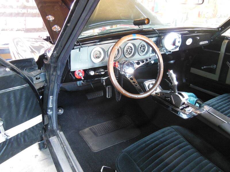

final welds and pins done,,upper and lower flanges r welded. support bearing on lower shaft. both upper and lower shafts r collapsable just like stock vue installation, makes for an easier install on my 63. wiring is next..4 wires. And i am going to reduce steering wheel size from 15" down to a superior 500 13.5" walnut wheel. and if it ever dies, its just a matter of unbolting it from the flanges and installing a new unit.
Does it have power steering or not ... by the pictures, No. but with a closer look YES.
all done. powered it up today and was easily turning the wheels on the lift blocks..
money well spent.
