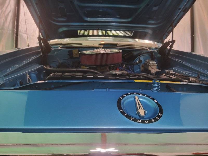

Engine mount have a look
snake
7:00 PM
Feb 2, 2009
153
58
canada

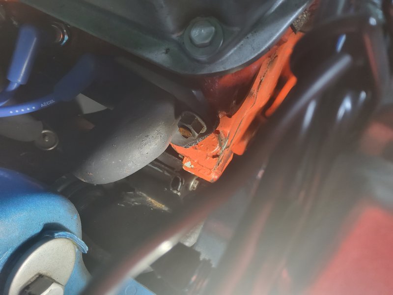

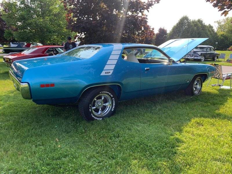

The rubber mounts are only 4 years old good thing I have the left side chained down.she is leaning
Loosen them off and shift the motor over?

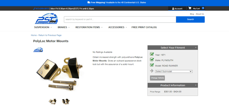

Anyone know part numbers for polyurethane motor mounts 71 Satellite 360 haveing a hell of time trying to find them thanks a ton.
didn't they call that a Detroit slide
What about solid motor mounts? They don't vibrate all that much in my opinion. I've changed motor mounts in the car. I used a 2"x4" on the pan rail, jacked it up, slip one out & one in
What about my headers and tyranny lines,also can I place a board on the oil pan and jack her up

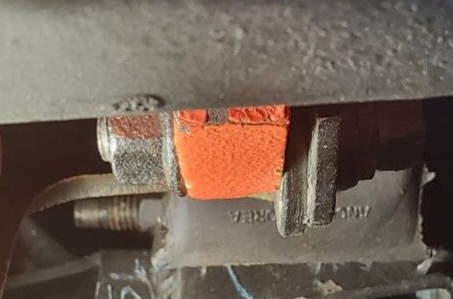

I got my homemade solid mounts I made the mistake of removing a few years ago. Really no difference.
I have went to solid mounts on all my cars after having a failure on a PolyLoc. No regrets....
What type of failure was it ?
Was actually the passenger side. Mike Schumacher was thinking it was caused by heat. I was the first with that issue, but not the last. He sold the company a couple of years later, so idk if they figured out exactly what the cause was.
