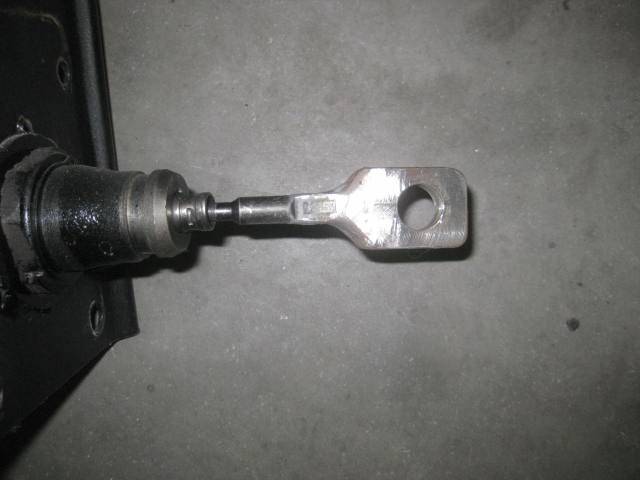

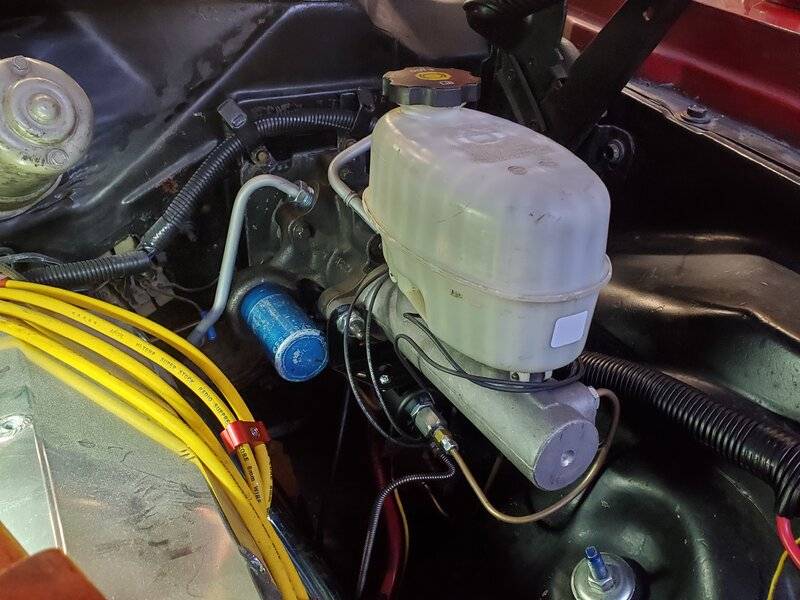

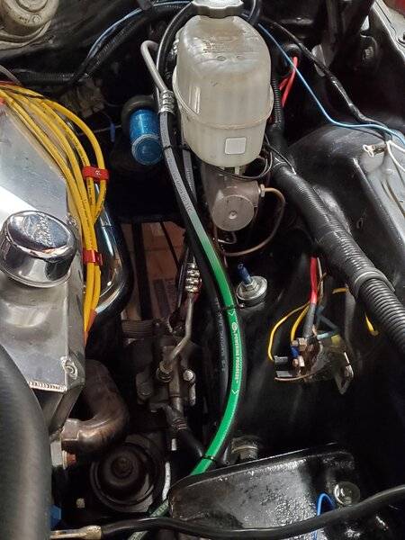

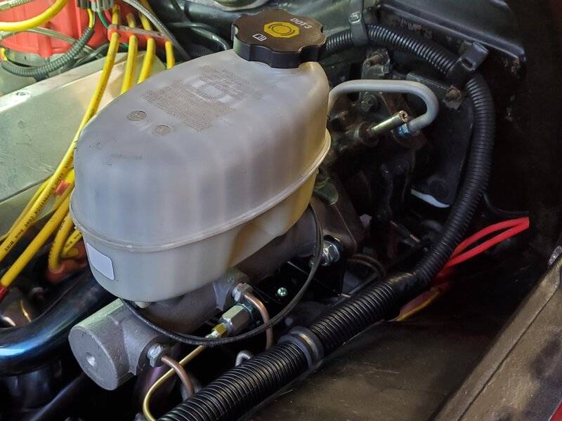

I did the swap on my 71 Charger. I have the hydroboost setup came off of a 2008 GMC Savana van. The brakes will put you through the windshield.
Did you have power brakes originally or manual brakes? I guess did you do anything with your peddle or use the OEM? What dia is the master cylinder?
My car was originally with no power brakes. I had to cut the pedal push rod in half on the car and the master cylinder and weld them back together. I am using the factory pedals. I made my own pressure hoses. I drilled the power steering tank and added a nipple for the hydroboost return line. I had to rotate the mounting plate 180, grind the tab off and weld a new one on. I am using the GMC van master cylinder. No sure of the size. I have 1973 Charger disc brakes on the front and I have an 8.8 inch rear axle with disc brakes. I love the way it stops.

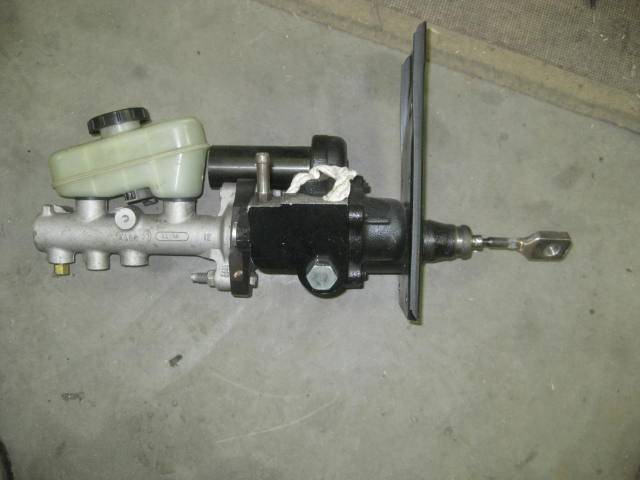

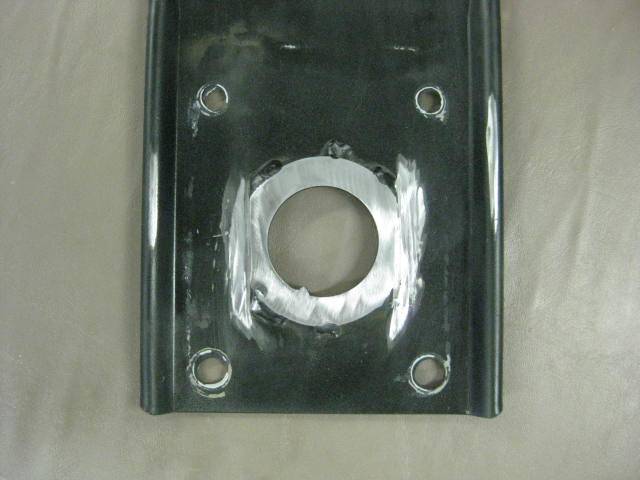

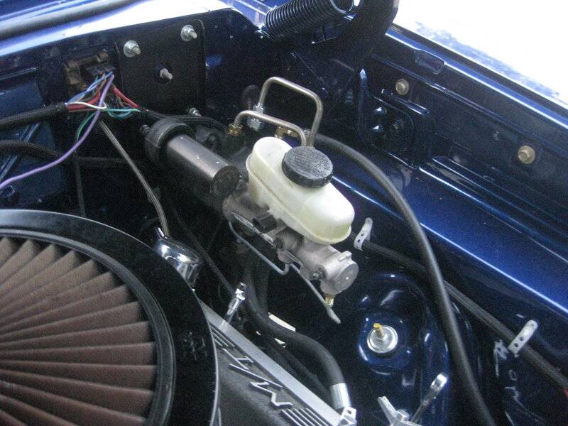

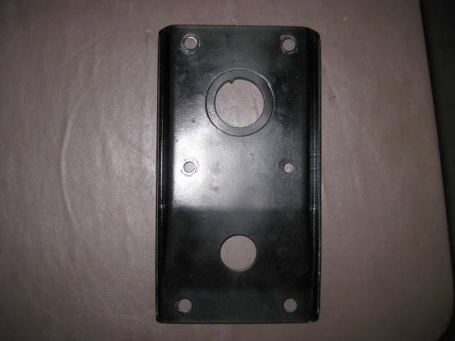

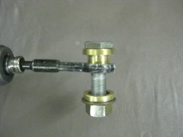

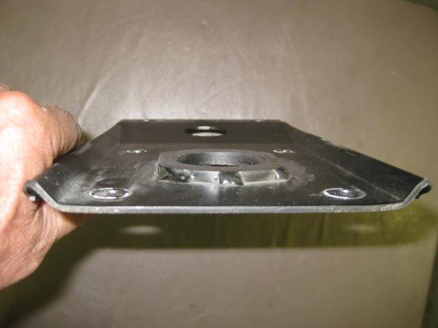

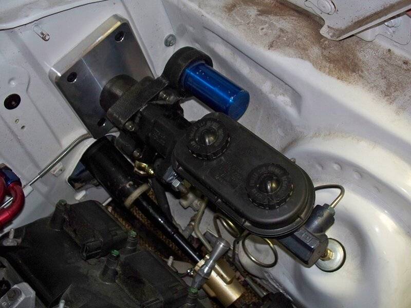

Welcome to the Hydro Club... did this one about 10 years ago... this was during the mock-up phase.
This HB came off a 2000 Mustang cobra and was fitted on 62 Polara 500
works great
