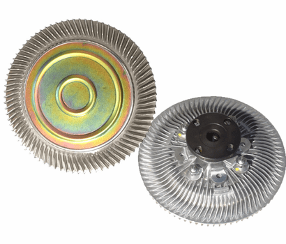

Was wondering if anyone could tell me the difference between an A/C and Non A/C fan clutch?
Non A/C clutches were viscous only and A/C clutches were viscous with a thermal control spring
so what did the spring do? was it affected by heat?
Yes it would expand and contract with temp and in turn it is anchored on the outer end and the center end is attached to a shaft that it turned that’s attached to a valve inside letting the fluid flow to control the drag on the clutch.
