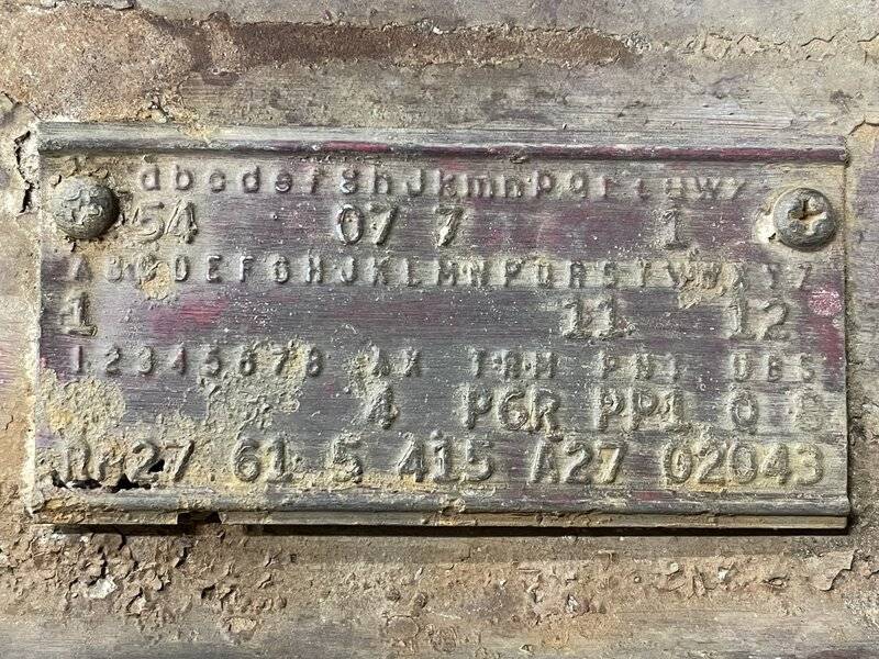

Hi guys, I’ve messed with the online decoders with some luck. Figured I’d post this for those that know what most of the codes mean. Thanks
I know the basics:
1967 satellite convertible
383 2bbl, Automatic
Red with white top and red interior.
ps,pb,ac.
Other than that, I have no idea.
CAR: Plymouth Satellite 2 Door Convertible
ENGINE: 383cid 2-bbl V8
TRANSMISSION: 3-Speed Automatic
TIRES: 7.75 x 14 Red Streak Tires
MODEL YEAR: 1967
BUILD DATE: October 27.
AXLE: 3.23 Rear Axle Ratio
INTERIOR: Premium Trim Grade, Vinyl Bucket Seats. Red Interior.
PAINT: Bright Red (Dodge, Plymouth), Scorch Red (Chrysler), Flame (Imperial).
OTHER: Dark Red Metallic (Dodge, Plymouth), Ruby Red Metallic (Chrysler), Plum Red Metallic (Imperial) Upper Door Frame Color. Stripe Deleted.
MOLDINGS:
ABC OPTIONS:
A1: 26in Radiator
R1: AM Radio
S1: Air Conditioning
X1: Tinted Glass (all)
Y2: White Convertible Top
abc OPTIONS:
a5: Center Front Seat
b4: Bucket Seats
g0: Chrome Belt Line Mouldings
h7: Fender or Hood Mounted Turn Signal Indicators
k7: Passenger Outside Manual Mirror
u1: Sold Car When Built (Somebody Ordered It)

Can you educate me how to read the fender tag? I have had very little luck with the decoder posted in another thread.

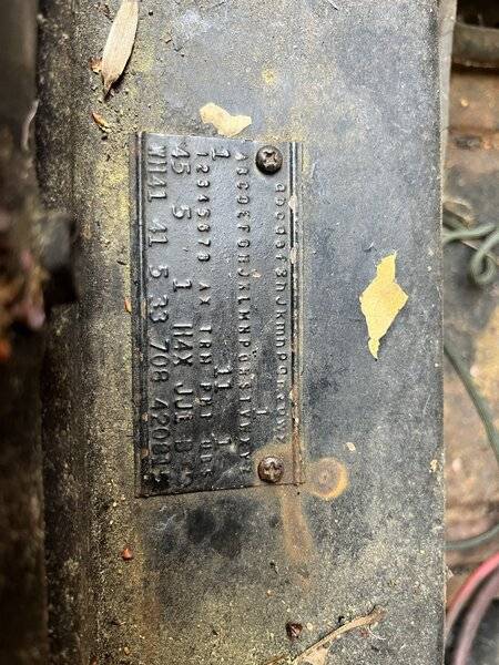

I use the Realdash.net decoder for 67-68 or for 69-74 for tags. You just have to make sure your letters & numbers are in the right spot. They don't always look like they line up right, but you can 'decode as you go' to make sure they are.
For your tag you provided:
CAR: Dodge Coronet 440 4 Door Sedan
ENGINE: 318cid 2-bbl V8
TIRES: 7.35x14
MODEL YEAR: 1968
BUILD DATE: July 08.
AXLE: 2.76 Rear Axle Ratio
INTERIOR: High Trim Grade, Vinyl Split Bench Seats. Black Interior.
PAINT: Medium Gold Metallic (Dodge), Ember Gold Metallic (Plymouth), Sovereign Gold Metallic (Chrysler, Imperial).
OTHER: Black (Dodge, Plymouth), Formal Black (Chrysler, Imperial) Upper Door Frame Color. Black Horizontal Accent Stripe.
MOLDINGS:
14: Sill Mouldings
25: Drip Rail Mouldings
55: Body Side Mouldings
ABC OPTIONS:
A1: 26in Radiator
R1: AM Radio
abc OPTIONS:
