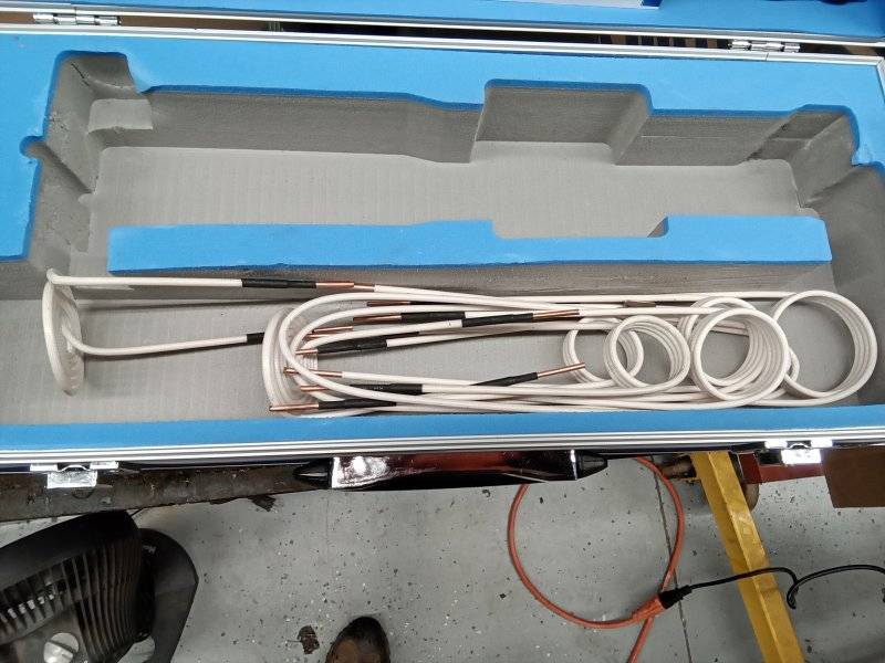

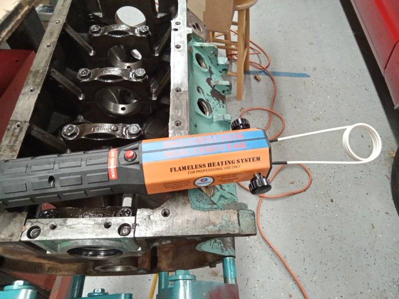

I have new pistons for the 383 that goes back in Ruby and was going to take the rods and stuff to a machine shop for the install. I have done wrist pins before but I am not a fan of using a torch or propane heater. It is really that I'm not fond of an open flame in the shop and will avoid it when I can.
Then it occurred to me to use the induction heater which I mainly use to heat rusty stuck things. So i figured why not, it worked like a champ. It actually took less time to heat the rod and was more uniform during the process. No open flame and the only thing hot is the rod. It was perfect
