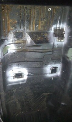

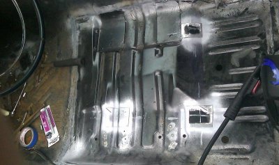

Not knowing right from wrong, When I replaced the floor pans in my 66 bel, and re-installed the 1972 Chevelle bucket seats I formed and welded in doubler plates and used big washers well. IMAG0569[1].jpgIMAG0572[1].jpg
