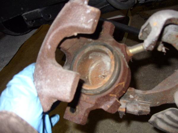

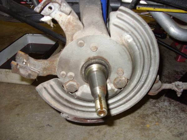

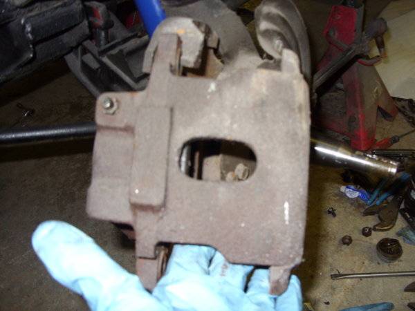

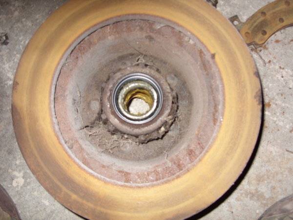

Someone changed my dads 62 polara front brakes to disk. I want to put on new rotors, bearings. I have no idea what they are from. They measure 11 3/4 Anyone have any ideas ?

One piston. I didn't think you could get disk brakes on a 62 dodge. To me it looks like a newer set up

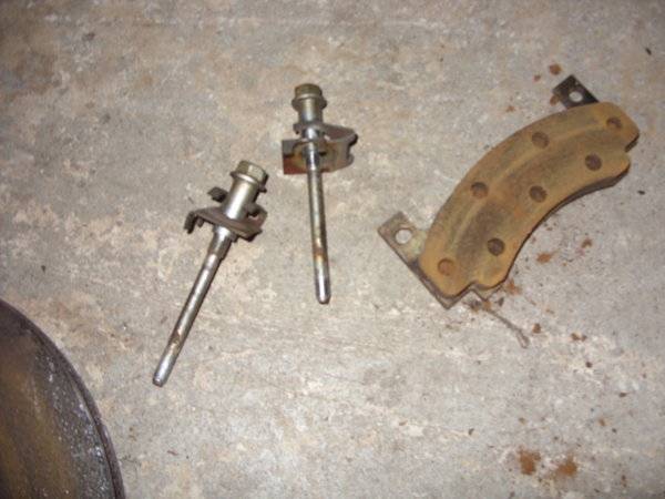

pic 12 1st pic 2nd is whole setup.

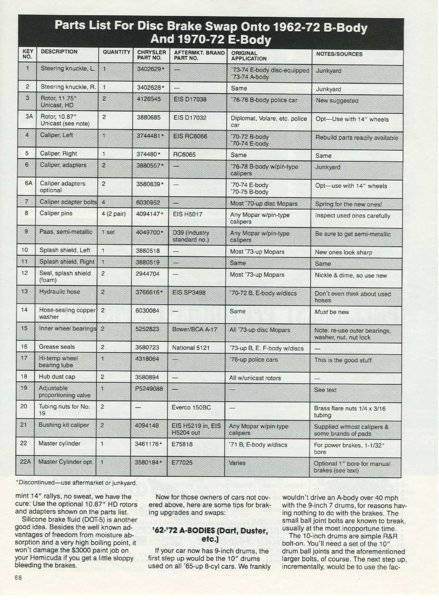

Try 77 aspen volare. Lots of conversion back in the day based on aspen volare.

I’m not into early discs, but if you take a paper tracing of a disc brake pad you should be able to matchup what you have at parts store. ( c’mon guys, he’s a new guy) I don’t know this old crap either. I still run & love my HD drum brake setup!

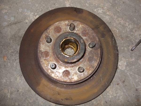

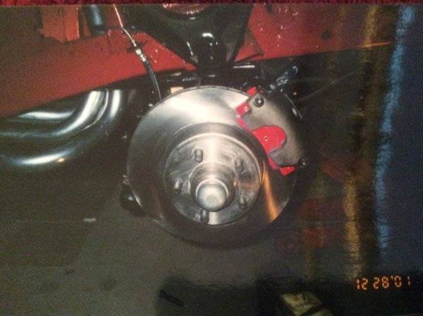

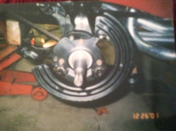

Your caliper looks the same as the one I posted. Rotor not sure back looks different but yours could be a factory rotor, mine and ones in pic are after market.
Bring your rotor & pads to your local parts store, have them look up latter 70's mopar to match them up. Hopefully there's someone that knows parts there, not a noodnik like most places nowadays. I used to have a parts guy, Frank, I didn't even have to tell him what car it was, he could identify a part just by looking at it.
I did the disc brake conversion on a 71 ebody many years ago and the 113/4 discs were from a 77 Cordoba.
