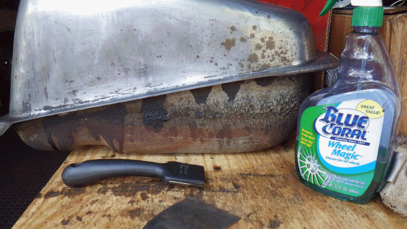

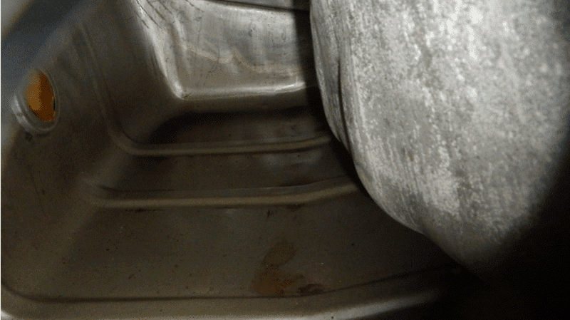

Just did this. Wanted to keep my original tank, but in the long run it’s better to buy a new one. I also found my sending unit was bad, I’m changing all of the hoses and lines, even tho they look ok. I reused my straps and painted them to match, and reused my locking ring, which I also painted.
IF I had to do it again I'd go with new if available. What a PITA!
The inside was pretty clean...
Outside it was another story...
I think the only thing I didn't try on it was that Goo Be Gone stuff.
Came out fairly nice....

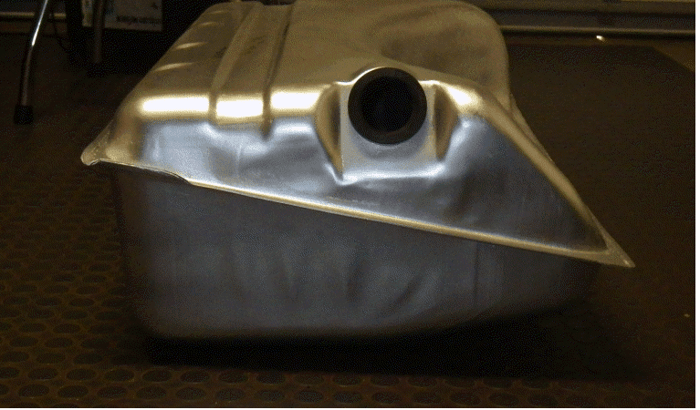

That seal sucked. Allegedly for the application ('69 Barracuda), the fill tube would not go in it. The DMT seal worked great.

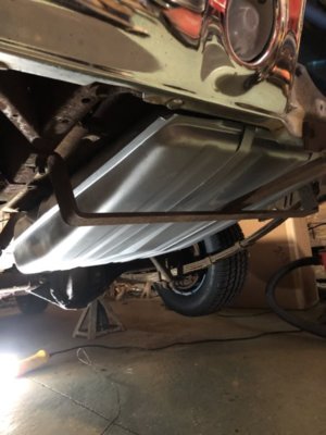

I just replaced mine using a stainless reproduction tank.
