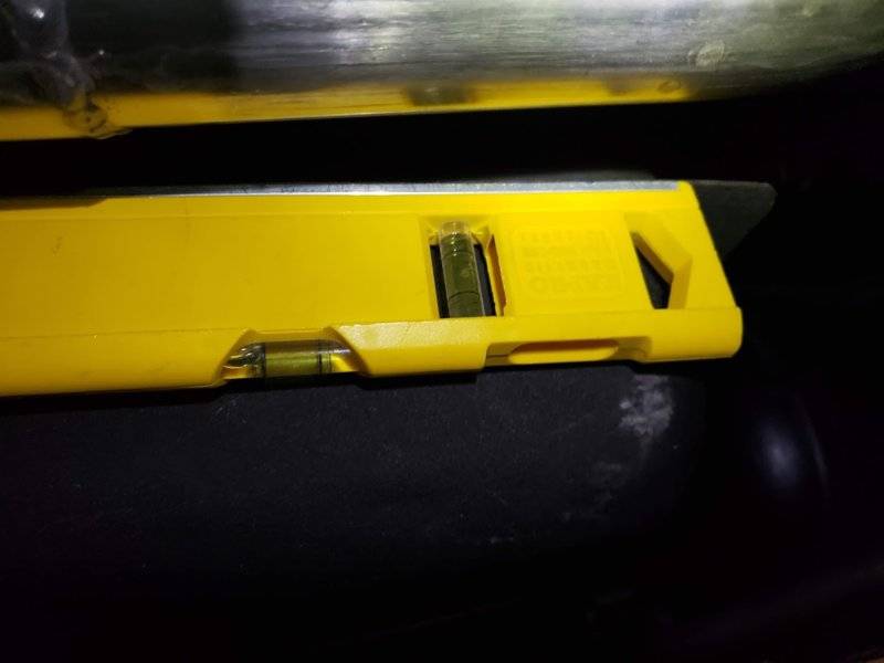

Filled up my gas tank (1970 Coronet) for the first time, got home... noticed a puddle under the car. Gas was basically squirting out of the candy-cane vent near the front of the tank. Opened the cap and was immediately showered with gas. I removed about a gallon with a manual pump and no more leakage.
I've read ALL of the threads on this topic and they all revolve around the two vent lines not being correct, venting properly, or so on. But I have a different theory about my situation. When I filled it up, it took about 20.5 gallons, and there was probably about a gallon in the tank (I deliberately drove it to near-empty to test the gauge). However, this tank looks like one of those typical aftermarket B-body tanks that are advertised as 19 gallons.
So I think the issue here is that it overfilled. I did not "top-off", but filled until the first click-off. My theory is that either because I'm running bigger wheels on the back or simply because of an incorrect install, my gas tank is lower in the front than in the back, which means gas will fill up to the fill pipe opening and leave no air in the rest of the tank for expansion and venting.
I went under the car and used a level to see if the "side seam" of the tank is angled up toward the back. Indeed it is, by quite a bit:
It should be level, no? If so, what's the easiest way to correct this?

Some people on some threads say the same thing, that today's gas expands more so just don't fill it all the way. But I don't want to give up that easily. I am bothered by the fact that a supposed 19-gallon tank filled to 21-22 gallons. That's what still leads me to think that my tank is too much nose-down, which would let it hold more gas before triggering the shut-off mechanism in the handle.
