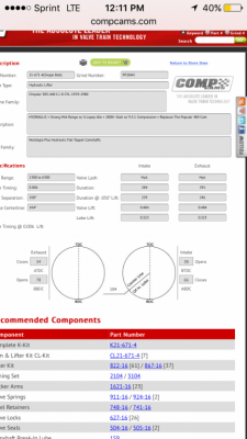

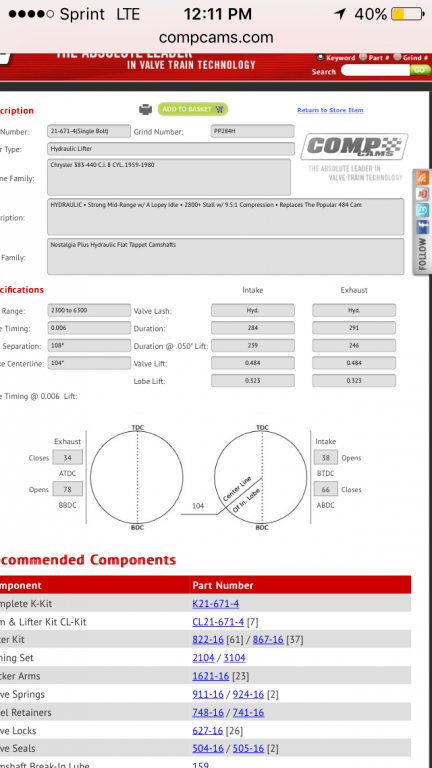

I have a comp cam and not sure about tire size what size would you recommended
I found it, what do you plan on doing with the car? Street driven mostly? Highway driving?comp recommends at least a 2800 stall and 9.5:1 compression, no gear recommendation
