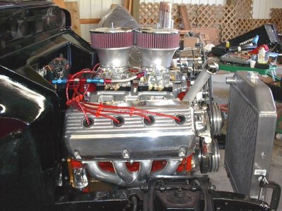

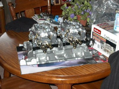

I had my headers and intake done with " Cerakote Chromex" coating which is good for temps up to 1100 degrees F it coats the inside and out and lowers radiant temps underhood. Mine has been on since 2004 and looks like it did when I first put them on. It is on my 392 hemi.
