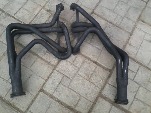

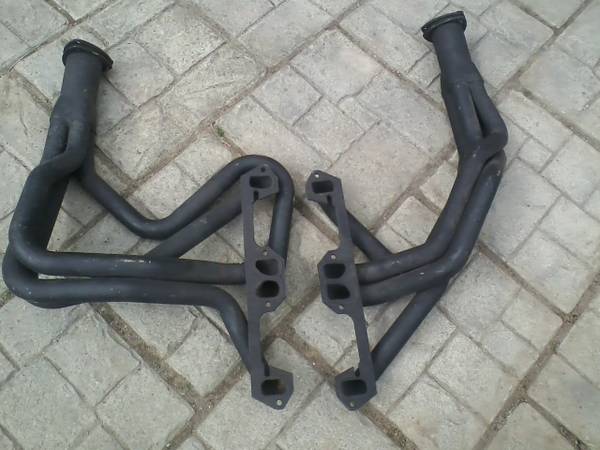

headers1.jpgheaders2.jpgLocal listing has these headers for sale for 100 bucks. Says they are for 318 to 360. Any way to ID from the photos? Look like a good deal?
I'll have to give him a call and ask. I'm wondering if they'll work for my 318 poly in my 66 Sat.
you can get new headmans for $139 through jegs.look about the same as those.same part # for 66-74,so just find out what they were in.
Those are later LA 318 and appear to be for a car as opposed to a truck. There may be a P/N stamped on the flange. If you need headers for a poly keep looking and be prepared to part with more US Gov't issued fun tokens.
Those must be the ones Dako has. I guess I'll be getting those too. Oh well, what's money if you don't spend it?

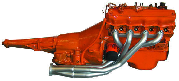

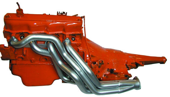

Satellite66; yeah they are pricey & not very many available "I think" here's some from Hooker Headers/Super Comp for like $633 on E-Scam Motors... you need the flange with evenly space tubes, not like the one you posted that are for latter LA or Magnum 318ci with a siemiezed together type of ports on the center 2 tubes... if you understand what I mean... you may try to call Schumacher Creative services tell them what you have & need they "might be able to help", they won't be cheap thou.... I found those on E-Bay under 318 Poly Engine, I think it was... there is a lake header kit also to build your own but probably not what you looken' for... Sorry those are the wrong type flanges just an example of the tube spacing see my next post, for correct flanges
Unfortunately these won't work either, if they are as pictured. Poly exhaust ports have bolt holes on top and bottom of each...not at the sides.

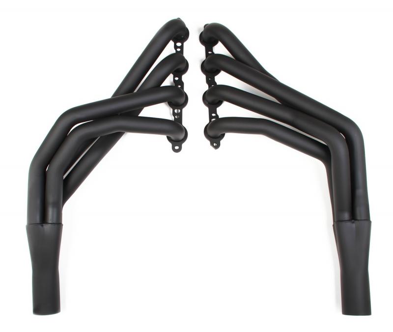

yeah too bad, I just saw/noticed that too, photo doesn't match the description typical, here are the TTI's below, I was trying to show an example of the tubing spacing etc.
