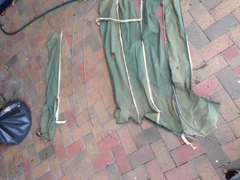

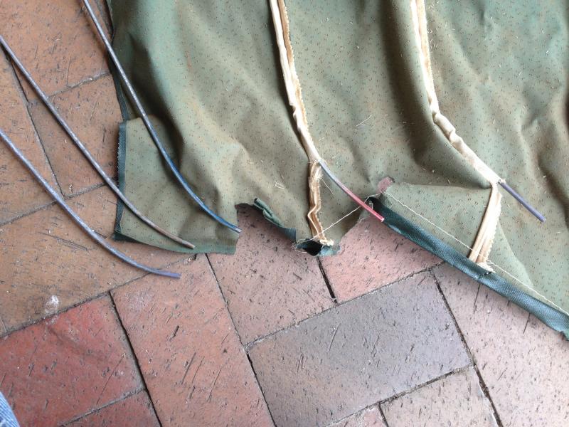

Hi all
Hoping some one can help decipher the order of the head liner bows in for 68 coronet.
The colours are still visible in the ends, but I've go no idea of the order bar the few that have managed to stay in the old liner.
Can anyone help?
On early a-bodies is
Front to back...
Brown
Green
Blue
Yellow
Violet
(believe to be the same for b-bodys) if No one else replies
thanks
I had asked this a few months ago but no replys. thanks for this info.
roadrunner68, tennessee
That order sure looks good to me except my 70 B has 6 bows with black being the rear bow.
