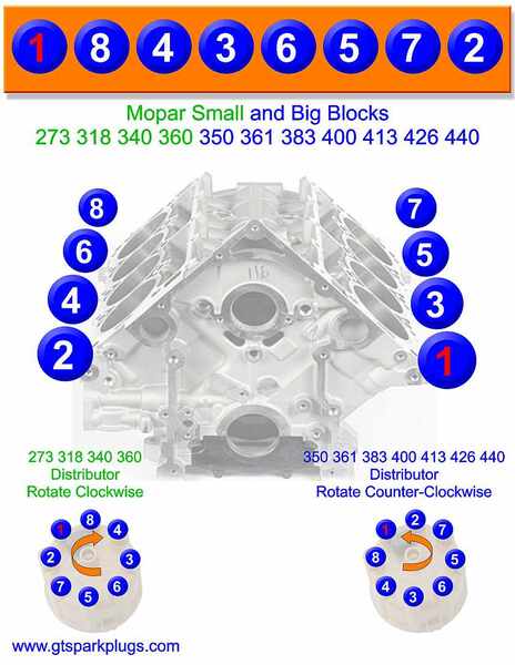

If you are , then where ever your rotor is pointing this is #1 plugwire. Get the firing order and install the rest of the wires, I belive the small block rotation is clockwise.

Get the engine on top dead center on the balancer. But make sure you are on the compression stroke. Easy to do if you already have number 1 plug out put your finger over the spark plug hole and rotate the engine till it blows your finger. Don't stick your finger in the hole.. Once it blows your finger stop rotating the engine. It should be on or real close to TDC. THen pull your cap off and it should be pointing to number one post on the distributor cap. That is where your number 1 plug wire goes. Then the Firing order is 18436572 clock wise.

It only matters if trying to reproduce the factory spark plug routing / locations, otherwise #1 is the terminal under the rotor with #1 cylinder at TDC compression.
