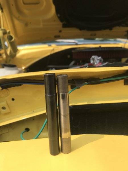

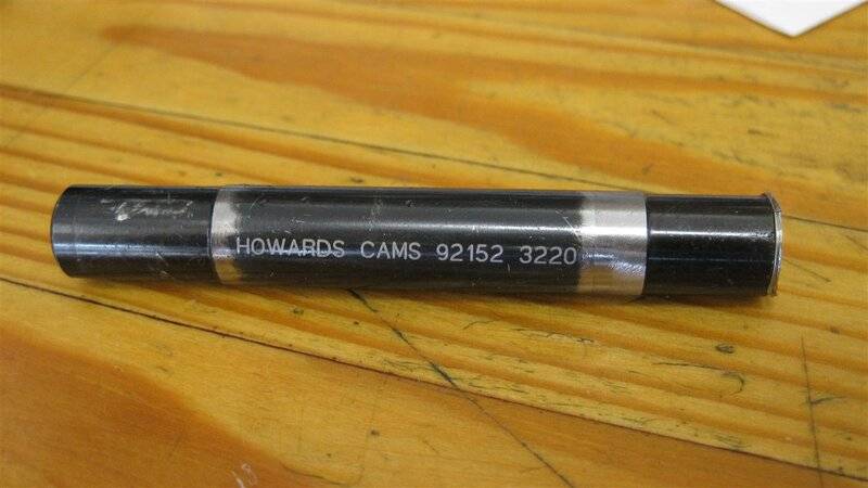

How in the hell does a cam manufacturer put out a product as soft as butter! I don't think I would trust their cams.
Did nos make a good one?.073 short. Run it and look for a oem or nos one unless someone has had good luck with a certain aftermarket one.
Seems like I may just use the one I have thank you.How in the hell does a cam manufacturer put out a product as soft as butter! I don't think I would trust their cams.
NOS = New old stock Factory stuff.Did nos make a good one?
If I get to the yard tomorrow I'll see if I can find one for you.Very true the old steel is I would bet way better.
Thank you sir.If I get to the yard tomorrow I'll see if I can find one for you.
Thats what I wonder comp used to make good stuff.How in the hell does a cam manufacturer put out a product as soft as butter! I don't think I would trust their cams.

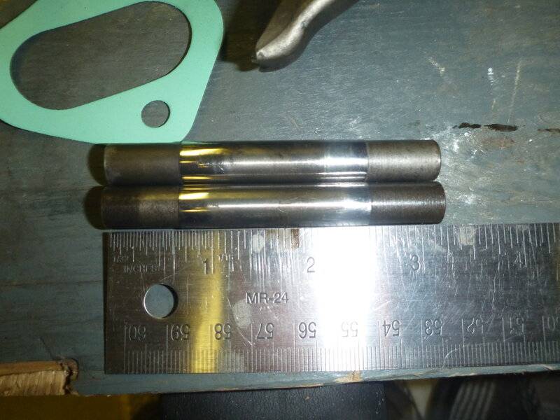

just want original 3.22 are some .432I have several used ones.....one is .220
Have never ever seen one at .432 even with low mileage......just want original 3.22 are some .432
My specs may be off.Have never ever seen one at .432 even with low mileage......
What is your best guess for stock diameter?Have never ever seen one at .432 even with low mileage......
Can only say what my used ones are.....What is your best guess for stock diameter?
Pm me your address and I'll send you (no charge) a good original I found today at the yard.Thank you sir.
The ones I have measure .434 diameter.What is your best guess for stock diameter?
It's about .005" under. And that was with 50+ years of use. I wouldn't hesitate to use it in my car if I needed one.3.220 long?
I know you have help a few on this topic from what i have seen comp and howard is a bad choice.The ones I have measure .434 diameter.
