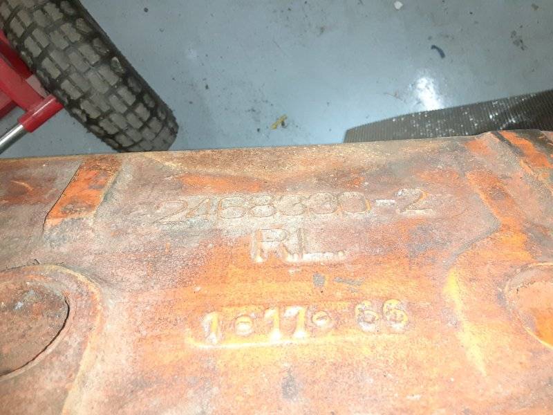

What do the different numbers on the pad by the distributor mean? No I do not have a pic of it, I just wrestled it around for an hour trying to find every number I could on it. I know it says B426. Casting date is 1-17-66, day shift about 6:25

Isn't that the casting date on the side of the block? Yes, that's what the maltese cross means, but I don't think I have the original crank. However, it still has main bearings in it which I'm going to pull out soon and can post up the part numbers if they are still legible.

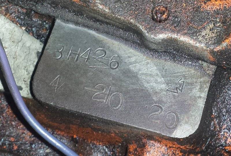

This is mine. April 20 assembly date. I don't know or I forget what the sideways T means (see the forget thread). The cross has already been commented on.
This is what I wrote. It is cast on the side of the block. I took a pic of the side of the block to post it but it disappeared from my phone. I will get another pic and post it here. My back quit hurting so I'll flip it back around and take a pic of the pad, but I believe the post above covered it for me.

I don't know what the other 20 is. It might be an indication that it's the 20th engine assembled that day. Maybe some of the other Hemi guys know.
There is a “W” under the assembly date and before the “T” and together I assume it means water test was performed.

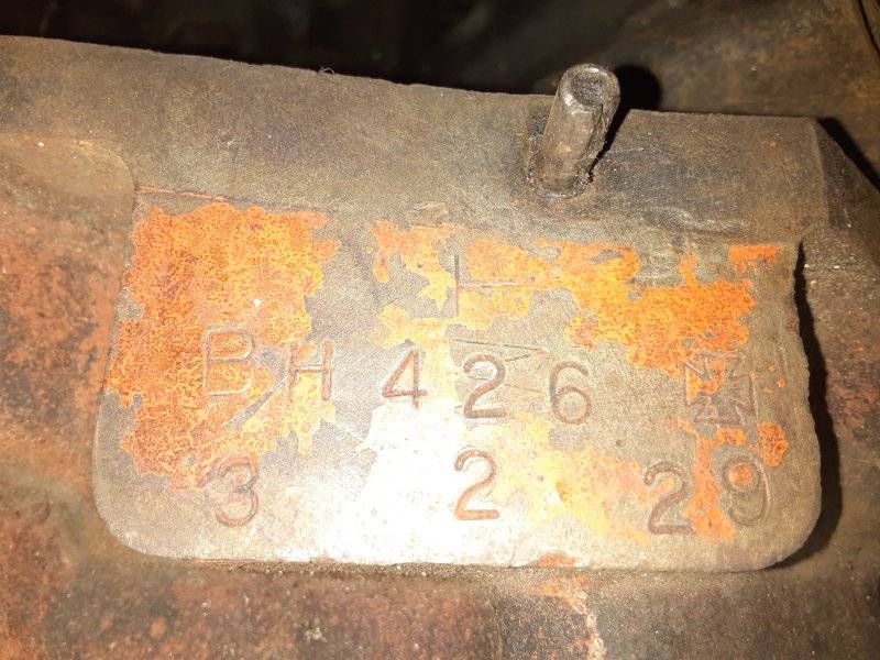

BH426 is 1966 hemi
WT is water tested .
Maltese cross is undersize mains,,,,,, I think ?????
And best i remember the 3 is 3rd shift , 2-29 is Feb 29th assy date

BH426 is 1966 hemi

I believe the 3 and 2 are March 2, and the 28 is the 28th engine that day? I mean if you look at the other 66 pad above, he has 4 20 20, which would be 20th month 20th day, otherwise I would have agreed. I think the first 2 are the month and day as that other thread linked here alludes to, however no mention is made of what the far right number means. I would ASSume, that means the number of engines built that day.
