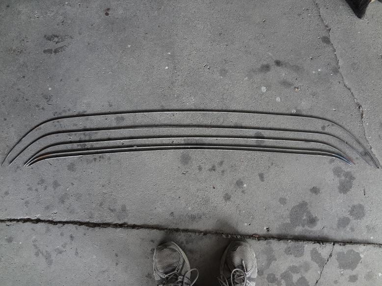

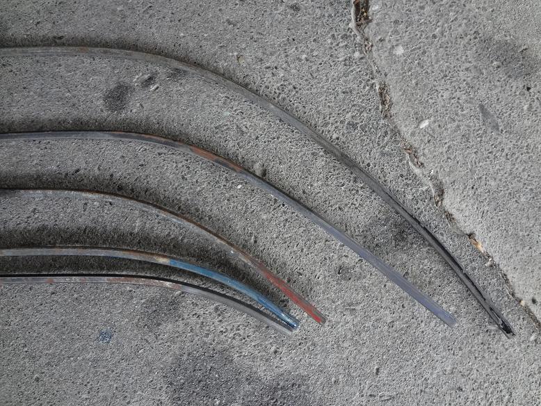

I am missing 1 hood bow, think it is one of the short ones. Each has a different colored end. Can anyone tell me what the order of colors is. Will try and make a replacement or last resort buy a full set.
Thanks Tony

This is what came out of my 70 road runner:
FRONT
Brown
Green
Blue
Red
Gray
Black
REAR
Fantastic Photon440, this the info I wanted. Looks like I need to make a Brown one. This info will also be of great use to another Kiwi building a 70 RR and missing 1 bow.
Cheers, Tony
