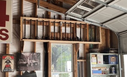

I have a few spare axle shafts on my rack in the shop...
The only reason that I saved most of them is because they have the right side adjusters on them. Only 4 of the 17 shafts are the 68-70 B body length so I'd like to see about removing the bearings and flanges of the other ones here using my Harbor Freight press. I checked YouTube but didn't see any videos of anyone doing this on an 8 3/4 axle.
