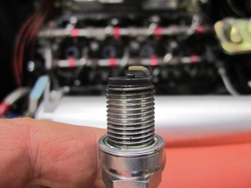

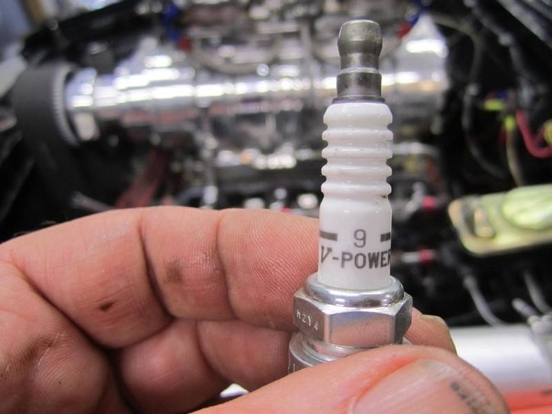

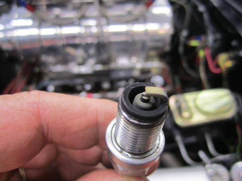

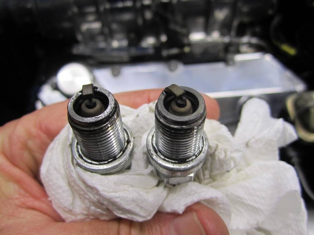

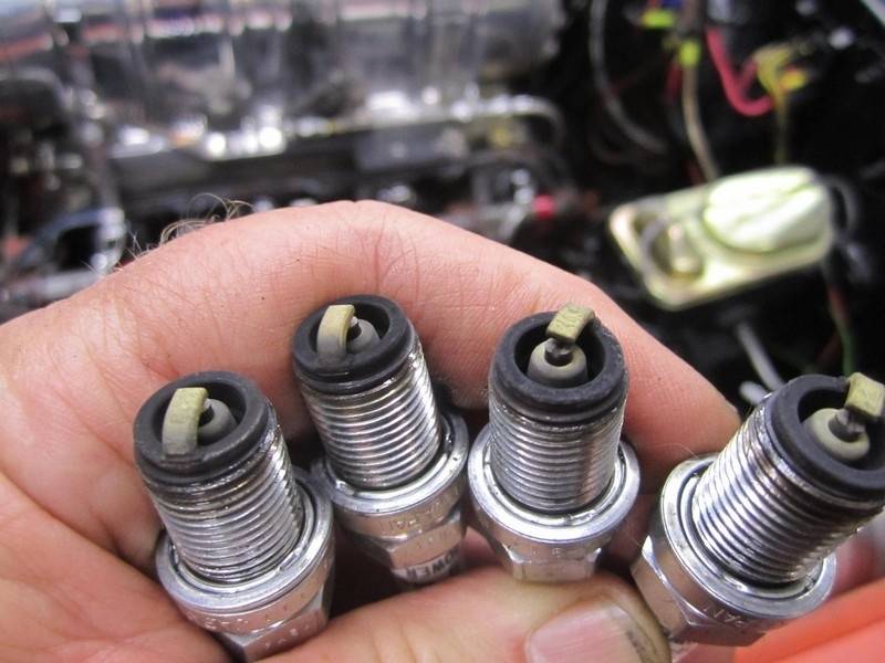

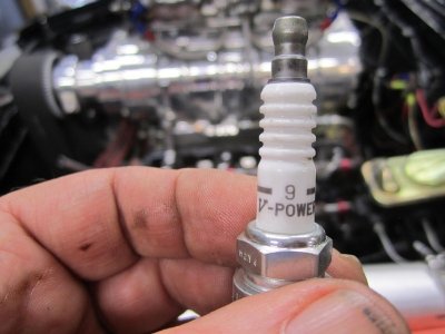

In my pictures above yoe can see the dark plug,then after a jet change they looked MUCH better.
