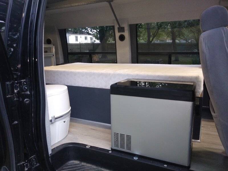

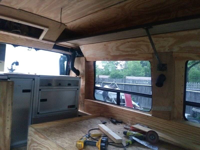

because I have to show somebody, you guys are it.........

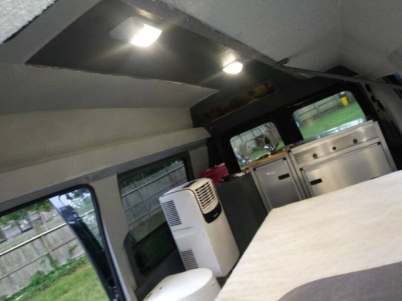

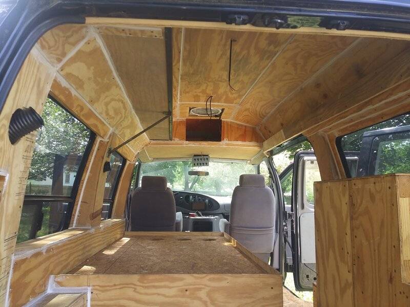

right before covid, my older brother scored a 3/4 ton "quigley 4X4" high top Ford conversion van...... he asked if I wanted to build him an off grid type mini motor home
never backing down from a challenge, I said "Hold my beer" ...... and proceeded to gut what was there
and then it snowballed........... and over the next 20 months, I proceeded to stuff 20 pounds of goodies into a 2 pound box
it has, in no particular order.....
on demand hot water for a shower
a portable chemical toilet
sink and 2 burner stove combo
45 gallon water tank supply under the bed
AC powered air conditioner, and portable gas generator
portable awnings and tent room rear and side
roof exhaust fan
refrigerator
exterior lighting
reverse camera
big *** deep cycle DC batteries power all the accessories
AC power inverter
200 watt solar panel charges the batteries
i may have forgotten something
it kicked my ***...... but eventually, I came out on top
I have a bazillion pics, here are a few

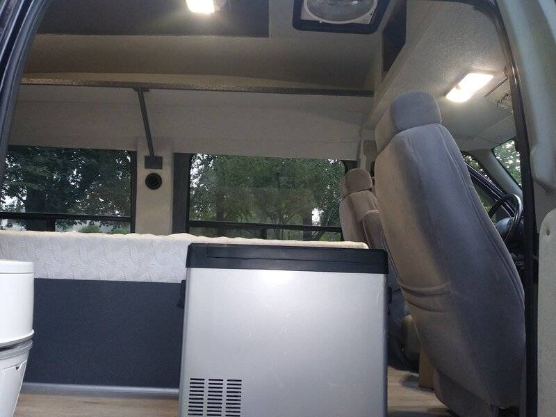

Looks great, you must have a **** ton of hours into that build! 440'
That looks Great, and a lot like my '75, when My Dad & I did the interior in it, around 1977. Wish I'd had taken some pics back then, but Kodak cameras, flash bulbs & cubes, and developing, weren't in the budget...

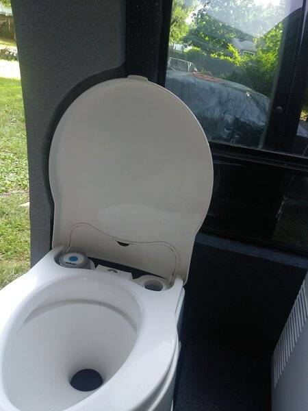

Great work, you have a talent for coach work! I think my favorite shot is the shitter by the door.
A block away from me is a guy with a similar set up, late model E250 4x4. He’s an avid kayaker and goes up in the mountains in that rig, kayaks strapped to the roof.
Well done!!!! I love vans and a 4x4 is even better!!
Looks like he can do everything he needs to do while sitting on the pot. Very efficient! Nice job.

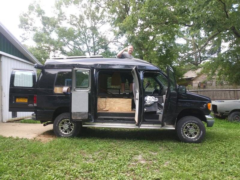

thanks guys....... yeah, damn near went broke with all the labor hours; but it was a cool change from the usual rust repair/paint stuff..... I'd put in a week here and a week there
he lives upstate ny, and took it home for a shakedown/test and to get it out of my hair for a bit....... it will be back for a few finishing touches....... the only rattle/squeak I had to deal with was the rear doors needed to shut tighter

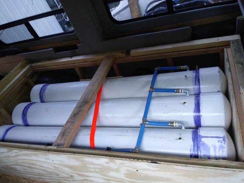

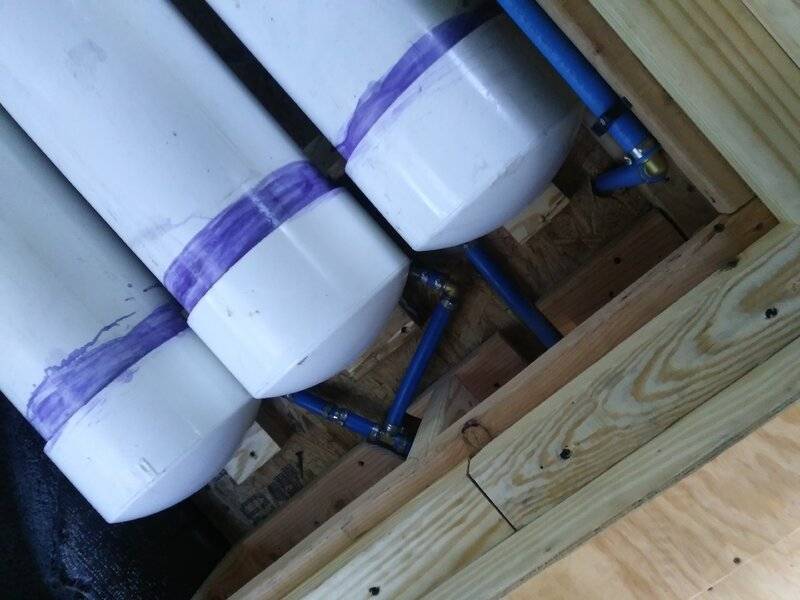

here's the water tank, I didn't want it to slosh around so I made it out of three 8 inch pvc tubes....... it fills/drains through a hose bib on the bumper and is vented

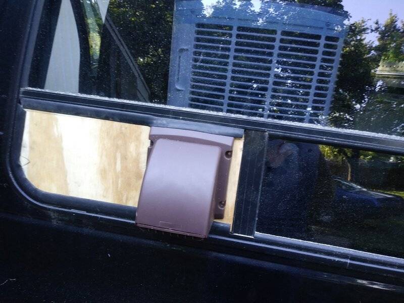

and nothing says mobile meth lab like a dryer vent hanging out the side :lol:

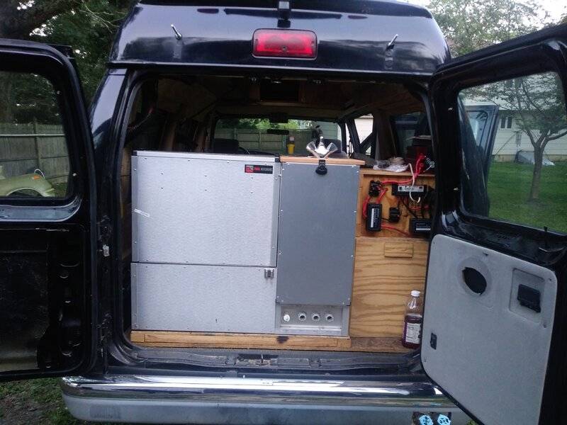

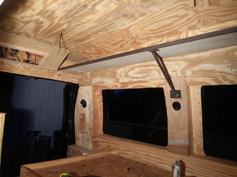

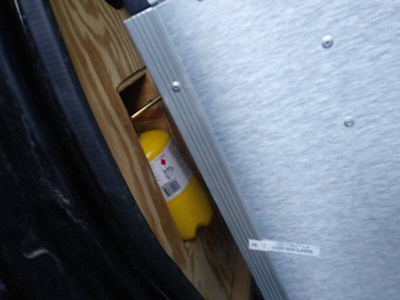

the deep cycle batteries live in the top of the box behind the "power distribution" area...... then feeds up to the hole in the top/rear to a boat style fuse box....... the portable generator lives underneath in it's own box...... disregard any of the old, existing cheesebag build you see in any of the pics

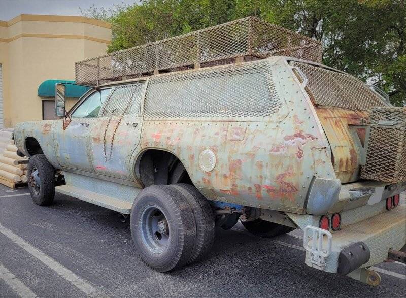

and the clown

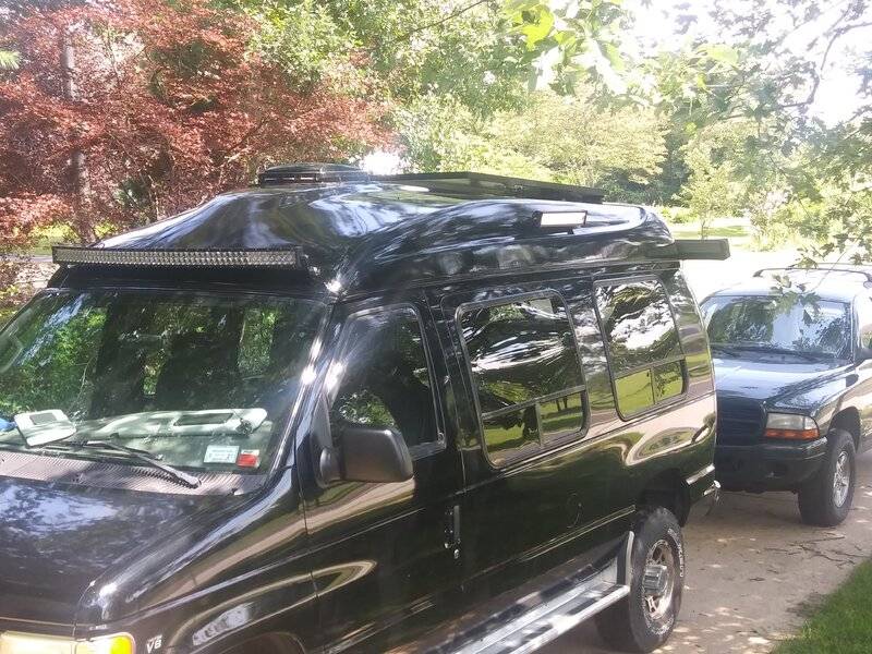

the huge LED on the front, and the other 3 (right, left, and rear) can be turned on manually, but also can be set in "security mode". each has a motion detector; anything within 40 feet gets blinded...... the front light also has a switch to source power from the van battery while driving, or from the solar batteries while in security mode.......... the front motion detector makes for a cool hood ornament
