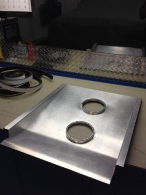

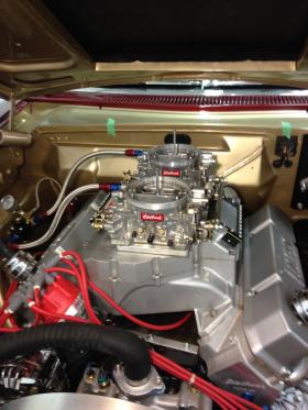

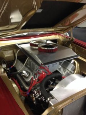

image.jpgI decided to post a few pics of the plenum I made that seals the carbs on my Indy intake to the hood on the 64. The hood seals nicely to the plenum and it holds it in place so when it's time to make a run, just pop the air cleaners off and shut the hood. image.jpgimage.jpgimage.jpgimage.jpgimage.jpgimage.jpg
That style pan is worth 1.5-2 mph on mine. Nice job, as always.

That's interesting to hear how your car picked up with the pan. I hope to get similar results. We'll find out next year.
