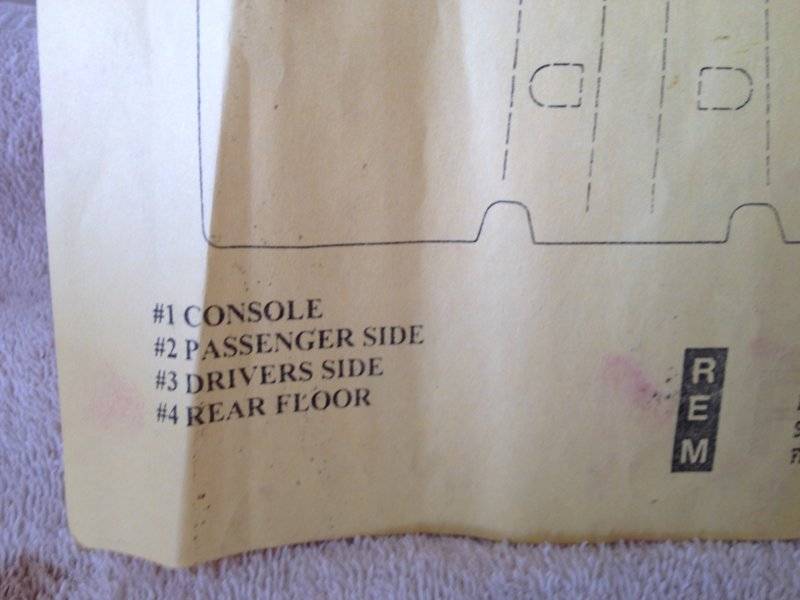

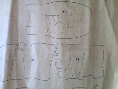

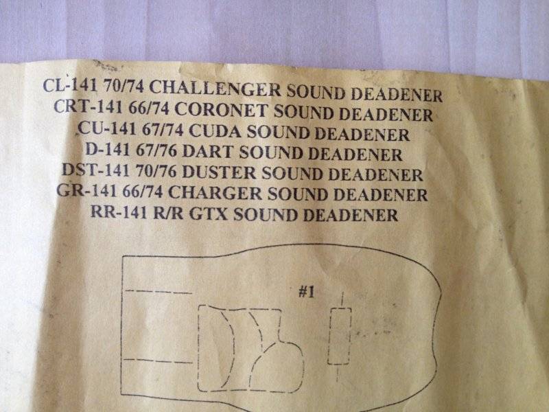

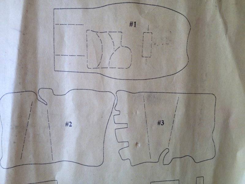

I have a complete set that I need to get rid of. CHEAPLY!!! Just want the set gone!!! Pm me if you have an interest and we can discuss it. Again, not wanting a lot of $$$'s...cr8crshr/Bill:thumbsup::thumbsup::thumbsup::usflag::usflag::usflag:
