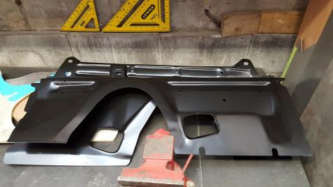

Looking for a good source for inner fenders for a 69 Roadrunner.
Just had a pair show up from Rock Auto (American made not Taiwanese) and they are absolute junk
Rock Auto sells something made in America?! I'm amazed....so, just what is wrong with them?
Hi Mike,Sorry to hear your luck with rock auto,iam not sure were to buy any more.Were are u living now,Thanks Mike.
Hey goon are you able to return those fenders to RA? If not I need some and they will need to be heavily modified for my 67 so junk is ok.
AMD sells inner fenders for 66-70.
Just looking at AMD now. I didn't order these but the shop was told they were flawless when they did.
They will take them as a return.
The AMD is a bit more pricey but will see what I can make work and how fast I can get them.
Just ordered a pair of AMD from Summit :)
Man, I see what you are talking about!! But looks like you have a buyer already...
What prompted the need for new inner fenders?
Car had some front end damage in its previous life. Part of having everything out gave me a chance to have the frame pulled straight and cleaning up some of that mess. Both inners had some wrinkles and warps and since we need to do some clearancing for the supercharger it seemed best done with straight pieces
Can't blame you for fixing them while your at it anyways, I tried a few brands on my Charger and the AMD stuff was by far the best. Good luck
Yes those look absolutely positively horrible. Like someone took some junkyard panels and massaged them with a sledgehammer. But.. if the price is right, as most rock auto stuff is, i may consider. I didn't know rock auto even sold body panels. Do you have a link for these, goon?
AMD ones fit nice. Just used them on the '70 Charger we are working on.
Much Better!
