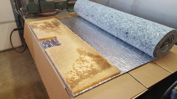

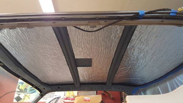

Dynamat sound deadener does little, if anything, for heat insulation. Use the jute that comes with new carpet or get a product designed for insulation. I used Bonded Logic product in my cars.
http://www.bondedlogic.com/ultratouch-radiant-barrier/
Now that looks exactly like what I bought from Home Depot. Had to order it on line. I'm wondering if the request for automotive use prompted them to change the name. It has almost the same description as what they originally used for heating duct. I used it on my roof and under the carpet.

Mine is the double sided aluminum backing. That stuff holds water like a sponge. So, make sure you seal all the edges with aluminum tape and your car has no water leaks before you spend the time and money on the floors.
Gotcha. I used the one sided and placed the insulation to the metal. It's almost like jute and that's what the factory did. It's actually recycled blue jeans. I tried burning it and it won't burn.
