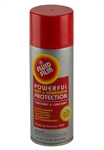

Make sure that once you finish doin your thing, coat all the moving parts in lubricant. My favorite is Fluid Film
