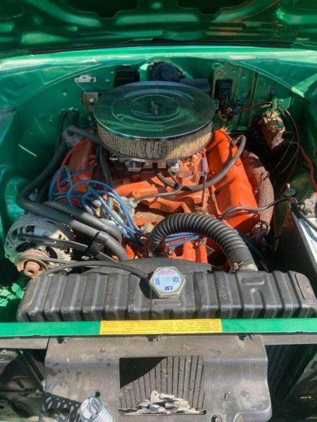

Black dash. Color I can't figure out. 440 but no 6 pack. Thoughts?
What's is the VIN,do the body stamping match the VIN? it's not uncommon to see the original 383 get replaced by a 440.

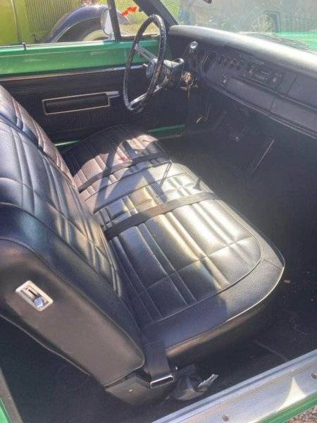

Rallye dash- check but
Shouldn't it be woodgrain?

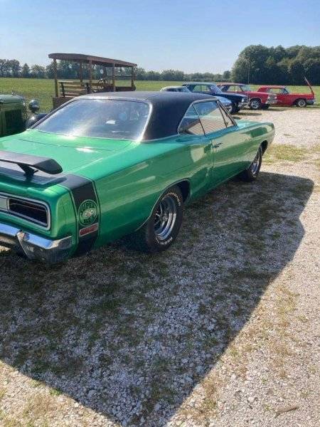

Is that 1969.5 "spring special" green?
Taillight trim panel has black stripe not red.
That's kind of concerning.
Do those look like AC sliders but not an AC dash or firewall?

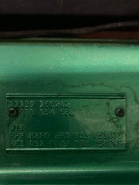

I got it
WM23:
Dodge Coronet,Charger
Medium, Super Bee
2 Door Hardtop
N0A: 383 330HP OR 335HP 1-4BBL 8 CYL
1970
Lynch Road, MI, USA
156249: Sequence number
E63: 383 cid 4 barrel V8 High Performance
D32: Heavy Duty Automatic Transmission
EF8: Dark Green Metallic (Dodge), Ivy Green Metallic (Plymouth), Jade Green Metallic (Chrysler & Imperial) Exterior Color
N2F8: Trim - Unknown, Vinyl Bench Seat, Green
588: Unknown Int. Door Frames
B03: Build Date: November 03
051071: Order number
V1W: Full Vinyl Top, White
888: Unknown
058: Unknown
668: Unknown
888: Unknown
0058: Unknown
668: Unknown
21139: Unknown
160242: Unknown
Probably got a couple things wrong.
All I have concluded it the motor is not original but it appears to be a real mid level SuperBee.
Yep, she's been messed with.
The unknown three 3-digit codes are engine assy, rearend and brakes code, and trans assy code.
I don't have my book here, can't translate, unfortunately.
The car came with F8 dark green paint and green interior. Looks to be F6 now.
Pretty large number with non original drivetrain and a different color.

Wrong door panels also. Should be a wood grain dash - all 1970 superbees were wood grain dash
According to MOPAR, yes. But more than a few guys on here bought them new off the lot or know someone who did and some came with a black dash. That aspect always immediately makes me think it's a poor clone but sometimes it isn't.
Not saying you’re wrong, but I’ve never heard of anyone saying “my 70 superbee came with a black dash.” I’ve also never seen a real one in person that had a back dash.
I'm just repeating what I have read on here.
