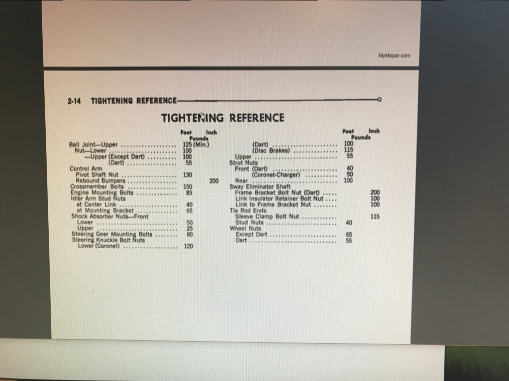

Can anyone verify the FSM torque specs for the K-Member bots and the Cross Member bolts? Seems like the FSM has them reversed.
FSM states:
Crossmember Bolts: 150
Engine Mounting Bolts: 85
I am assuming engine mounting bolts refers to the 4 k-member mounting bolts.
Was able to find the transmission crossmember specs.
90ft lbs.
Still looking for the k-member specs.
Well, looks like the FSM refers to the k member as the crossmember...duh. So, 150 it is.
