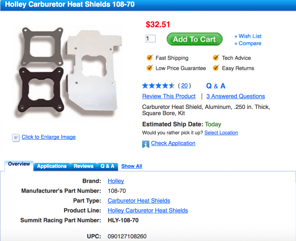

Go to summitracing and look at carb spacers. Delco had a real nifty spacer with aluminum in between the gaskets that extended out 2-3" fore&raft to cover the float bowls on Holley's. Used it myself years ago.
I have wondered about this fuel pump... I had a glass filter on there for a while and it would often rarely get full.. But yes i will try the spacer first though.
Looked at summit didnt see the delco but found this Holley one that looks decent.
https://www.summitracing.com/parts/hly-108-70/overview/
I agree on the phenolic spacer, but be advised when you use one you're gonna be raising your carb higher, and you need to account for that with the throttle cable and kickdown. I have an Edelbrock Performer, 1" aluminum spacer, and a 1/2" phenolic spacer, and I had to cut the legs off my throttle bracket and weld them back on with a 2" spacer to make everything work again.

Thanks bruzilla Ive got an aftermarket plate that mounts on the carb bolts, hopefully Ill only have to readjust it.
