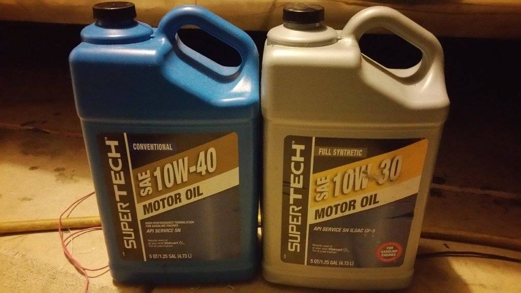

I used to use Castro blended on my daily years ago and got 250,000 + miles and still going. I took the engine out and put in my current daily dr. But I've been using these now the grey bottle is for the R/T and the blue bottle I use in the other 3 cars. Two are over 200 thousand miles. When I needed zink I used Lucas additive.
