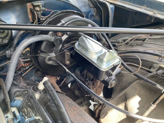

Force 10 sells an aluminum MC that works for disk or drum.
I just installed one on our Cordoba and it seems like a fantastic piece!
May not be what you are looking for but it's another option IMG_4759.JPEG:thumbsup:

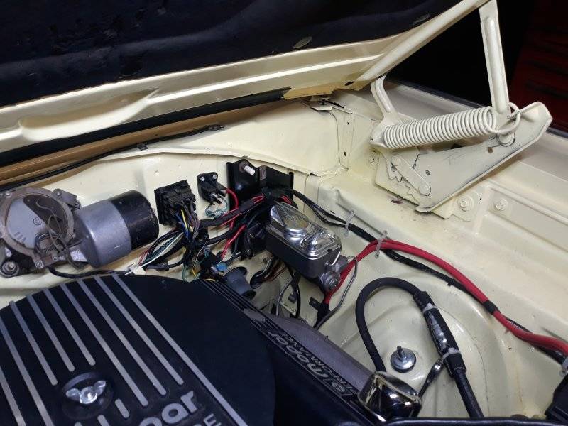

Blast from the past when I completed my disc conversion.

Got one the other day.
I should have it bench bled and on the car this weekend

Got bench bled.
And on the car.
Much..MUCH better stopping ability now.
Car actually stops now without to much pedal effort required.
A good feeling finally when i drive it.
