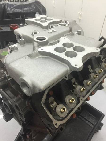

My '63 MW project is moving along, where I'm hoping it will be rolling this Summer. I'm wondering what exhaust port gaskets to use, that will hold up the best ? I'm using cast iron heads, along with MW cast iron manifolds. Any and All recommendations appreciated, Thanks...
I use Mr gasket header gaskets on my Iron max heads, but I use hooker adjustable headers with individual tubes.
I would try to get a real machinist straightedge, see how flat your manifolds are. If they are good, I think mopar originally used no gaskets. Maybe worth a try.
From what I read, lots of people swear by remflex. I have no personal experience with them.
