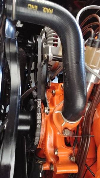

hey guys, hope everyone’s spring plans are going well! Looking for some fan belts to get the rides out of moth balls. Mopar number
B0015475.
Does anyone know if these are available still? If so where might I find them etc.
Any help greatly appreciated! Picture attached.
Thank you,
Jeff
Totally available at O'Reilly, Autozone, etc. All you really need to know is the length of the belt (& sometimes its width). O'Reilly computers even go back into cars from the late 40's I believe + they still have paper catalogs
If not going for “correct” that’s a 15/32” x 47-5/8” belt. Used to have to cross-reference all the time. Dayco/Goodyear numbers always work!
