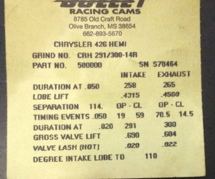

Have you run this combo? I am actually curious, not being a dick.. I ask because a friend has a Gen 3 392 hemi with a little smaller cam, I have his cam card, and his does land at 2 degrees ovelap, just like the very well respected Brian Tooley stage 2 turbo cam. My friends car makes 1,300 HP, and I saw him run an 8.1 at 178 this year, so I guess it works.
I have not yet run it. We still have to wire the EFI. I think somehow you may have gotten fixated on one parameter of a complex puzzle. These engines are still operating on a pressure differential, just a different version of it than an NA engine. Scavenging isn’t such a concern as you have manifold pressure to fill a cylinder so overlap is less critical. Once opening and closing points are then determined, overlap and lsa are merely fallouts of the numbers. You can manipulate those points to affect turbo spool or in my case crutch the rather smallish 75mm turbines hence the exhaust duration. I’m also running non-intercooled so power will be fuel limited. We’ve made 1635Hp from a Procharged SBF and have gone 8.0@170 with a Y2K on a yates headed 361sbf so I have some experience with forced induction combos.
The 528 cam will have similar valve overlap timing as the TBR Stage II cams
Hmm, seemed like a good bit more, 2 vs. 17, I am likely missing something. The only reason I am probably over fixating on the overlap is the only two guys I know personally with any experience have very low overlap cams and made it seem pretty important, and the other combos I have seen run are LS platforms, and seem to run small overlaps.
That said.. I spent a good half hour on the phone with Bullet cams today, and the tech was really thorough, to the point he needed to know how big my intake valve was and how many pounds of boost so he could calculate how much extra spring pressure to recommend. :)
I ended up with 2 choices in flat tappet solids, and picked the smaller of the two. It's the same basic blank, but the ramps are ground off the Ford lifter diameter, which slows things down and makes it easier on the valve train. Even so, the tech said I am running on the high end of spring rates for a flat tappet.
Long story short, I was looking for a single digit overlap cam, looks like I will be getting one with about 20 lol.
