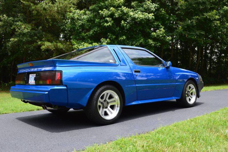

X2 mine was that stunning blue "Fiji Blue"I always liked the styling of those cars![]()
