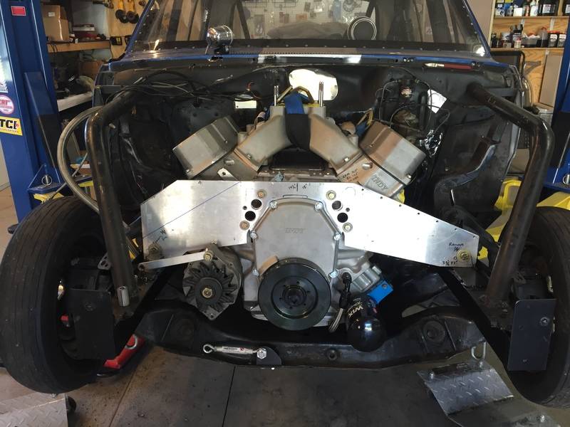

I was re-doing my drag car from one moto plate to another. Cut the mounts off in between so basically started at same point as if you cut off your mounts. I found dimensions for centerline of crank. Pretty sure TTI header instructions specified that location. I assembled a bare block & trans case and set them in. Used 2 bolts threaded into those longer coupler nut thingies to make little adjustable stands and put one on each side of the front of the blocks pan rail so I could jack it up/down/tilt. Got left/right by brute force and up/down with my jacks, then cut the plate to fit.
I don't have any pics of all that, just of the (near) final result

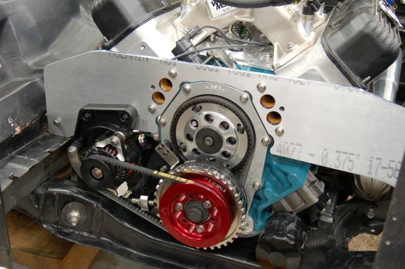

Mine was a generic plate that needed a lot of careful trimming to get it into the right place.
One thing I made sure to do is to get the plate trimmed exactly right so that when the plate was sitting on the frame rails the crank was located correctly THEN I drilled holes thru both the brackets and the plate in one shot. This makes it so much easier to install the engine. Bolts fall thru the holes when I set it down. No goofing around with crane & alignment.
