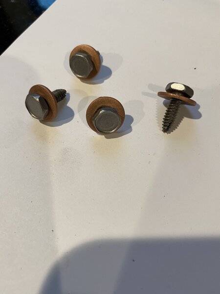

I have these 4 screws with captive copper washers. I didn’t know they were copper until I cleaned them after they were long removed from my 65 Belvedere sedan. I didn’t note where they came from. They also have a unique split point. Anyone have any clue as to where these go?

Steel screws will rot the aluminum - hence the copper washers.

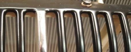

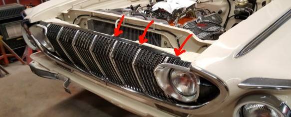

Yup.... The Kid Is Right on the money! They go along the top of the grille on my 65 Belvedere !
thanks Thunderlugs. I looked at my grille and there are 5 mounting tabs, but I only have 4 screws so I may have misplaced one. Do you see 5 across the top of yours? Thanks
Thanks - I was sure the copper had to do with either conductivity or metallic interaction.
On my '62 they were used along the top of the aluminum grill.

IIRC just the top screws have the copper washer. More than likely so you won't have rust from a steel washer running down over the grill.

Could be the rust from the screw that made the copper washer look rusty. I remember discovering the ones that I have as being copper only after I was cleaning them up on the wire wheel.
