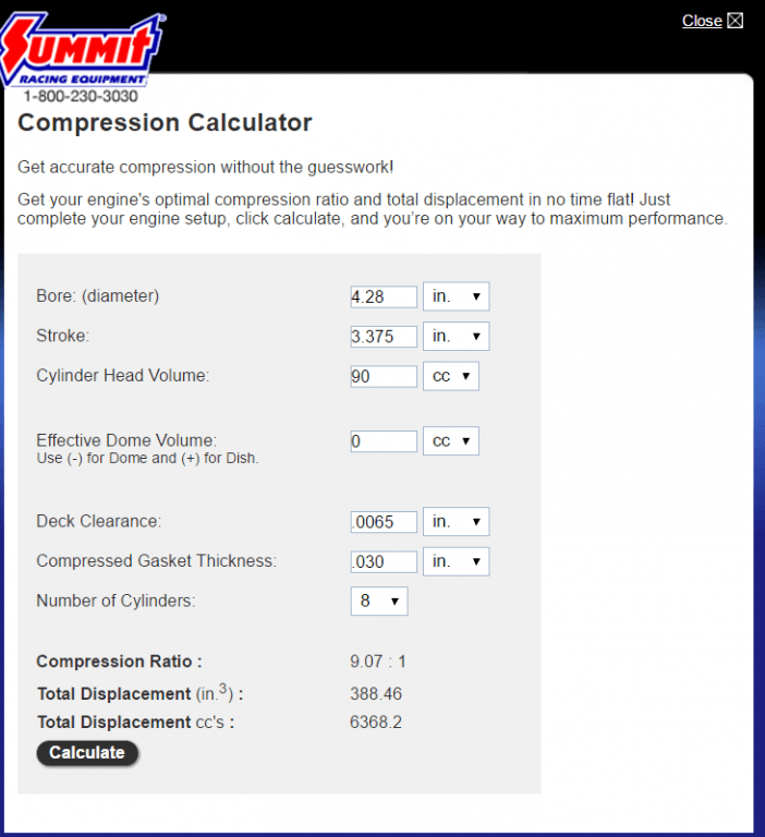

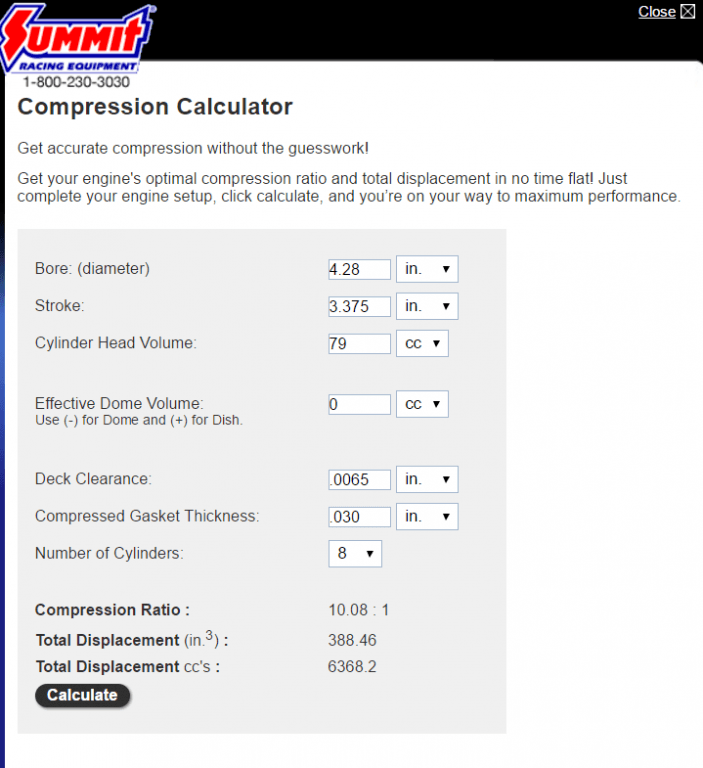

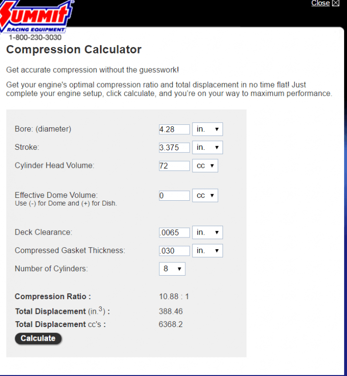

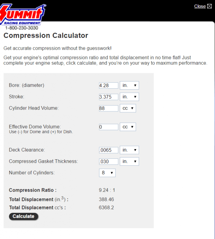

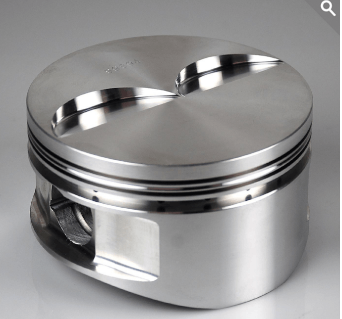

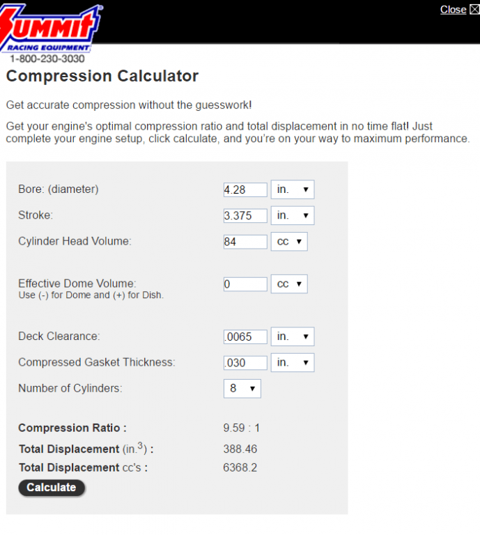

If things go well I will be ordering costum pistons from Ross Pistons next thur's day or friday based off of there 99894 383 Stoker design comp. height will be 1.928 which will leave the piston .0065 below the deck combined with a .030 thick head gasket leaves .0365 the minimum piston to head distance for close chamber heads. Wrist pin diameter of 1.094 for use with stock rods (press or floating I hope).
If any one has ideas on this i have not thought of or advice let me know before wed. 4/19/17.
Ross pistons were good for me years ago. Looking at the compression calculator be sure to figure the minus volume of the valve notches. Likely in the 4 -6 cc range, Ross can tell you that. With stock rods get them shot peened & use good ARP rod bolts. Which heads will you use? Old 906, 915 or 452 iron heads can make good power with a mild pocket port. Check with the engine builder about CR with pump gas. Seems like 9.5 with iron heads is OK, 10.5 works fine with EDE RPM Performers and pump premium. Good luck.
Any material removed for valve relief's i will have add back even if it makes a dome. hoping we can come up with a configuration that will work with any factory cast head and most of the after market heads. I will also include the .5cc area around the piston and cylinder wall from the first compression ring to top of piston.
think I will be going with eagle rods.
Just plug in the valve notch cc into the calculator. Decide if you are going stock style iron head or aluminum, makes a big difference in what CR you want.
