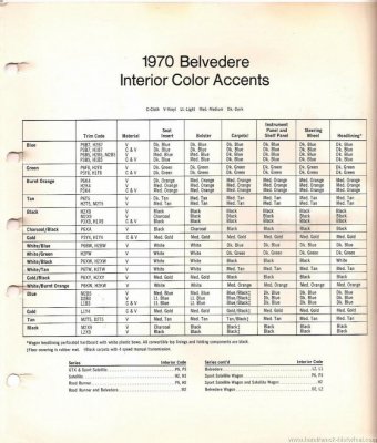

Hello, New to this forum, and recent 1970 Road Runner owner. I have a technical question on what items were what color on my RR. From the Broadcast sheet I have a RM21 Coupe with H2B5 Bench interior with EB7 UDF color. It also has the A87 RR Décor package. Also the Steering Wheel Code has B7. So what colors should the interior be for: Dash and Dash pad, Steering Column, Steering Wheel, Head Liner, Carpet, Package Tray and A and B Pillar Molding? I believe the right answer is B7 Blue for steering wheel and column, package tray and UDFs, but I don't know if this meant the carpet, dash and dash pad and Pillar molding also should be Blue. The problem was the longtime owner who never thought he would sell the car, was going to go Black on Black, so the Dash, molding, UDF, Head Liner, Carpet are Black. Thank you, G
This should get you started on some of your questions. Maybe someone can help with the rest. My interior is H2XW so I have all of the answers for that, but not so sure on yours. And probably wouldn't hurt to do a post in the welcome section to introduce yourself and maybe post some pics. We all love pics here. And congrats on the 70 RR.
Is restoring to as-built a prime importance ? You can sell the black parts you already have.
Plum Crazy RR Thank you. Just what I needed. I have been to that website but did not see the accent sheet. WileERobby, I am looking at options and most likely will change, either dye what I have or sell and buy. This car has a lot of originality at certain levels, upgrades at others and mismatch too. The second part is that the interior was upgraded to Buckets. The interior was redone prior to selling so I have a P6B5 interior (front and rear seats, door panels, and package tray). Black dash, column and steering wheel, carpet and headliner. I am going to keep it buckets, but am toying with going the P6BW route. If so I will have brand new seat covers, carpet and package tray to sell, along with black dash, and steering wheel. The reason I am thinking white, is this is an EB3 car with White Vinyl Roof. I take it door panels and pillar molding would match the dash color on the chart? Intend to introduce and post pics once I am settled in. Thanks for the help. G
