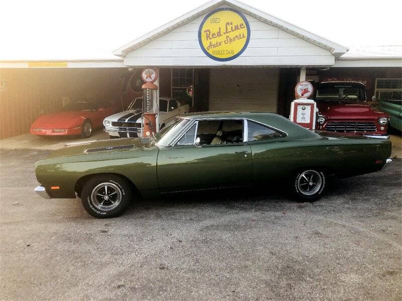

Hi guys, i'm from Australia and I'm in the process of importing a 69 RoadRunner 4spd with the 383....
this is my first classic ever, definitely mucked around with cars in the past however i'm no mechanic per se....
just wondering if someone can point me in the right direction for a maintenance guide on the road runners? just the basic stuff required on a regular basis to keep the old girl going strong.
car is going to be a "babied cruiser" i have new cars with warranties that i can thrash :)
so i guess, all i need is advice on how often to check/change the oil etc, etc....i could take it in to a garage on a regular basis however i'd prefer to do the work myself as its all part of the experience and i have an endless stock of tools at my disposal.
let me know guys., will appreciate the help.
