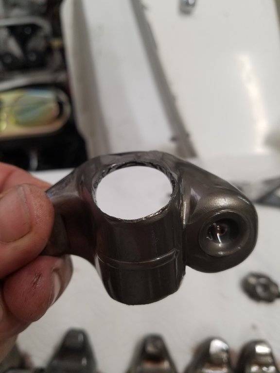

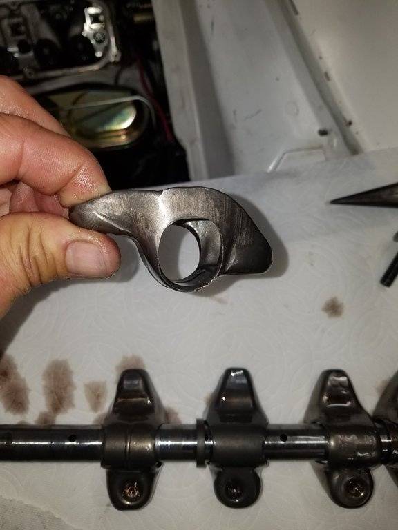

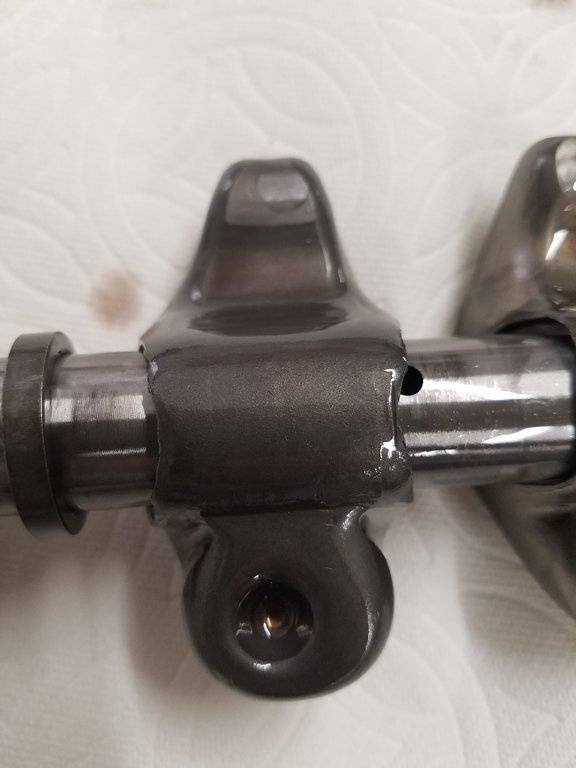

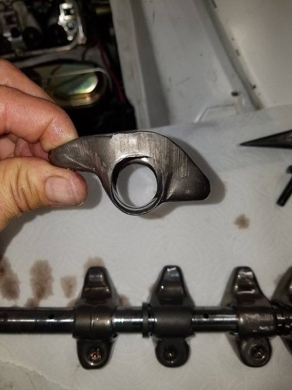

Hi guys...ok I know the factory style non-adjustable valvetrain makes a little noise but mine started ticking more than I thought it should, so I pulled the covers for a look and found this...

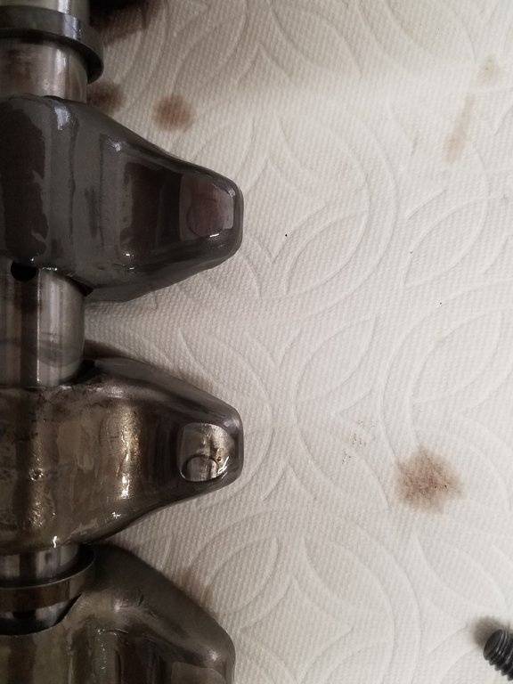

Actually, the factory style setup is supposed to very quiet unless things get worn out. I know a lot of rebuild shops that didn't replace the rockers if they looked good but I always liked replacing them.....unless they looked REAL good! You might want to replace all of yours along with new shafts and if you have any kind of a decent mild cam, I'd recommend going with the MP heavy duty rockers. Also, peel open your oil filter and look for metal particles and drain the oil into a clean pan and inspect it closely. Also check your valve tips too. Looking at that one rocker, the valve tip most likely is worn.

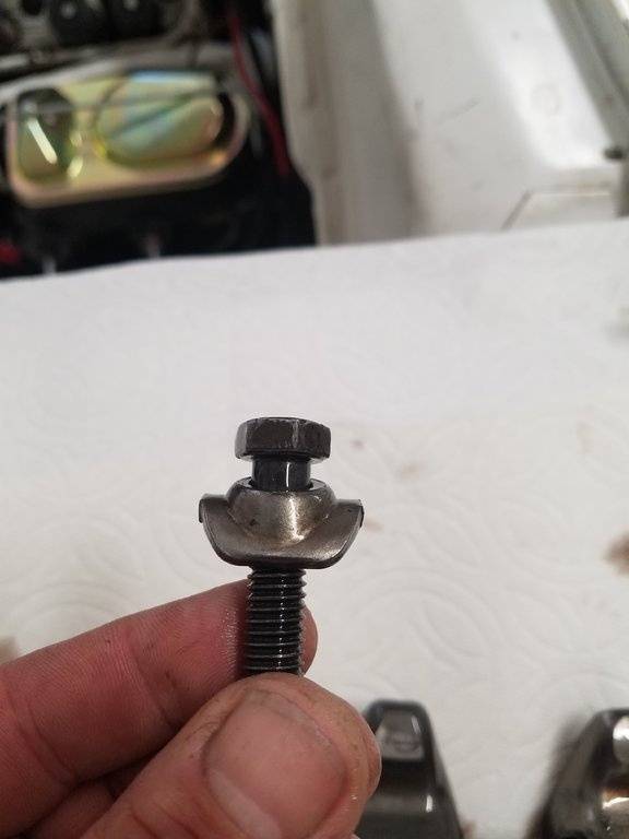

The cause was some of the hold downs did not have the raised nibs and were digging into the rockers, and the affected rockers were sliding from side-to-side quite a bit... no bent pushrods or shaft galling, I've only driven this car about 25 miles so far.. on a couple of rockers I see where they were not centered on the valve stem, so....new hold-downs and rockers and should be ok? Not really wanting to go to an adjustable set up as I don't have a very aggressive cam...(comp 274xe, 230/236 @ .050)
I would still inspect things....and would still go with the MP heavy duty rockers with that lift. They are stamped steel rockers and look stock but are just thicker and heavy duty.....non adjustable. Do you know what springs are on it? For .490 lift, a 933 (iirc) spring should be on it too.
Yes, the little turned up portion on the hold down has been worn away, or somehow got removed. I've never seen that before. I have run stock rocker arms with a .509 lift cam, and they worked great! Had many a 6000 RPM pass down the 1/4 mile with no problems. The secret is having the right amount of lifter pre load, as well as proper clearances with correct assembly.

OK good to know thanks Gary! By the way on the hold-downs....none of the smaller ones (3 on each head) had the upturned nibs...the wrong ones must have been used and I didn't know enough to question it, the engine was built years ago and before I fired it recently, I only pulled the covers to verify priming and check torque but didn't catch that...lesson learned!
