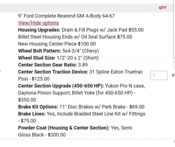

The Quick Performance rear axle assembly is cut/made for the correct 1" shorter width the 64-67 A body requires. They set up the assembly to "drop in" with all of the original suspension.
So I am interested in what you posted, but whoever you are referring to as the source (PM me if you can't post in the open) I would have to talk with them about how ready to install/compatible it would be.

I'll call the racetrack where we run Test and Tune night. For now, I have ordered the rear axle assembly with studs that will be covered by the lug nuts-if we can run like that, I know my wife would prefer the looks of the "decorative" lug nuts.

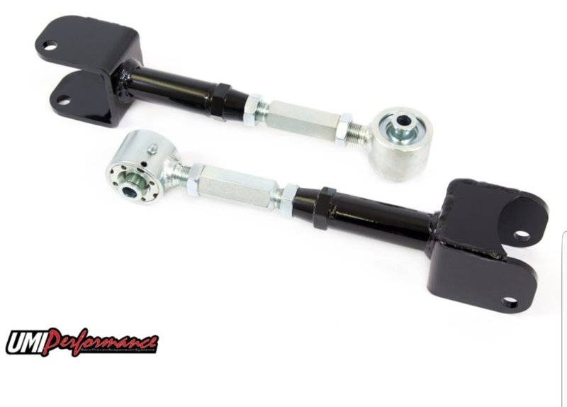

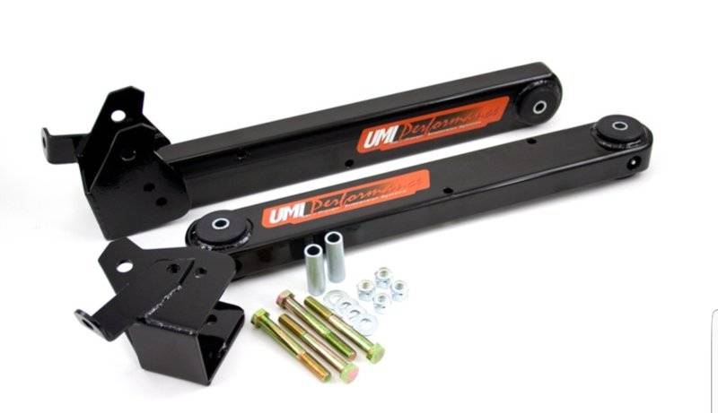

Rear axle w/disc brakes and Wilwood front disc brake set ordered. I'm also changing out the upper and lower control arms on the GTO while I'm at it. The lowers are called lift bars and use the rotational torque of the rear axle housing to push down on the tires. The adjustable uppers will allow for tweaking and adjusting the pinion angle.
