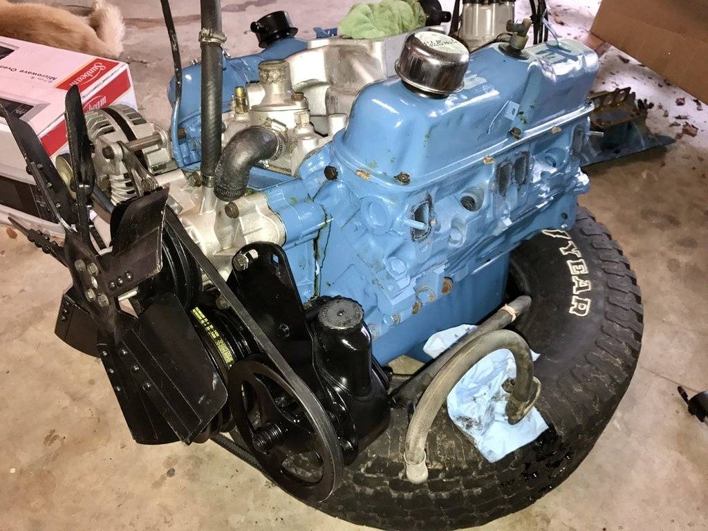

I am about to install my new 1978 360. The assembly turns nice and free but it's been sitting 1 year? 2 years? 5? Not sure. Should I spray something in the cylinders to lube the rings prior to startup? Any others ideas? The oil was full and looked fine and the antifreeze was nice and green. This is a crate engine with 15- 20 thousand miles before it was parked. Thanks.
