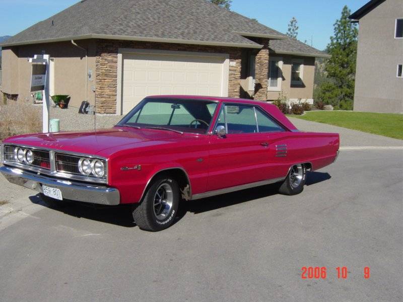

Reason for my "no stroking" is in your car: your car looks like an super-original, unmolested car, with no day2,3 or 4 mods...and I would keep it as such.
Even though, the 66`s did not have the VIN stamped in the block, so one could never guarantee, that your engine is the cars original engine.
In my opinion, a stock-restauration of the engine, will enhance the worth of your particular car.
